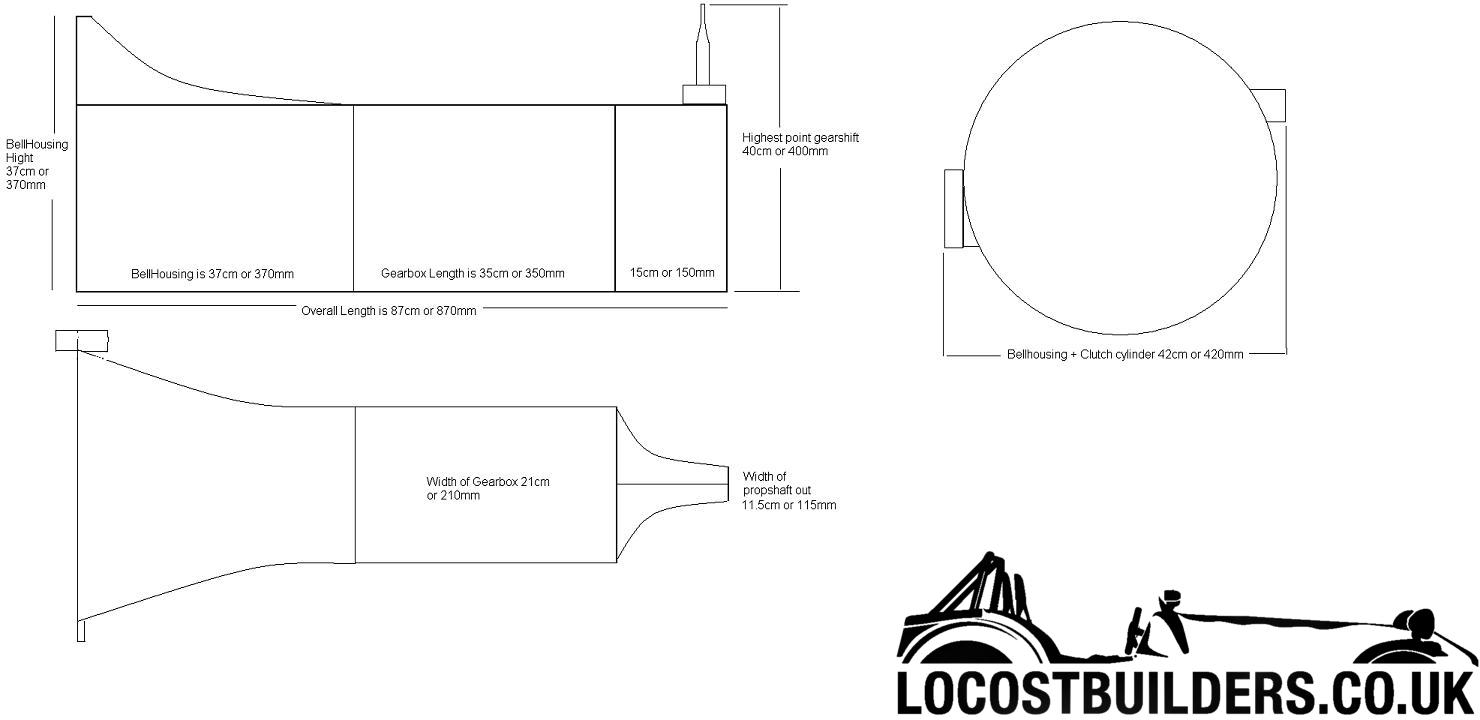

hi all, does anybody got the dimmesions off a mx5 mk1 1.6 gearbox?
or know if it fits in a mk indy tunnel without modifaction?
cheers
stuart

A while ago, i had posted the dimensions to a fellow locostbuilder.
Do a search
l0rd
posted on 19/1/10 at 07:31 PM Reply With Quote
http://www.locostbuilders.co.uk/upload/MX5%20Gearbox%20dimensions.JPG
[Edited on 19/1/10 by l0rd]
Stuart_B
cheers l0rd, just making sure that was the correct one for a mk1 1.6.
stuart
l0rd
posted on 19/1/10 at 07:32 PM Reply With Quote
the dimensions are exactly the same with the 1.8 version which i have for sale
l0rd
posted on 19/1/10 at 07:34 PM Reply With Quote
http://www.locostbuilders.co.uk/viewthread.php?tid=122089
original thread

I had to cut some alloy off my MK1 MX5 gearbox
There's a really big 'chunk' on the tail end of the gearbox which takes two very long M10'ish bolts that attach the gearbox directly to the X-frame chassis.
I cut this ALL off to get it into the transmission tunnel on my Stuart Taylor chassis. It's still quite tight - less than 10mm clearance in place. It's caused no problems so far and I've done about 7000 miles since completing the car.
