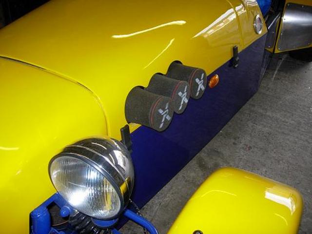

jacko
posted on 4/2/10 at 04:34 PM Reply With Quote
This is mine on zx9r carbs
triple filters 3
triple filters 3
[img][/img]
