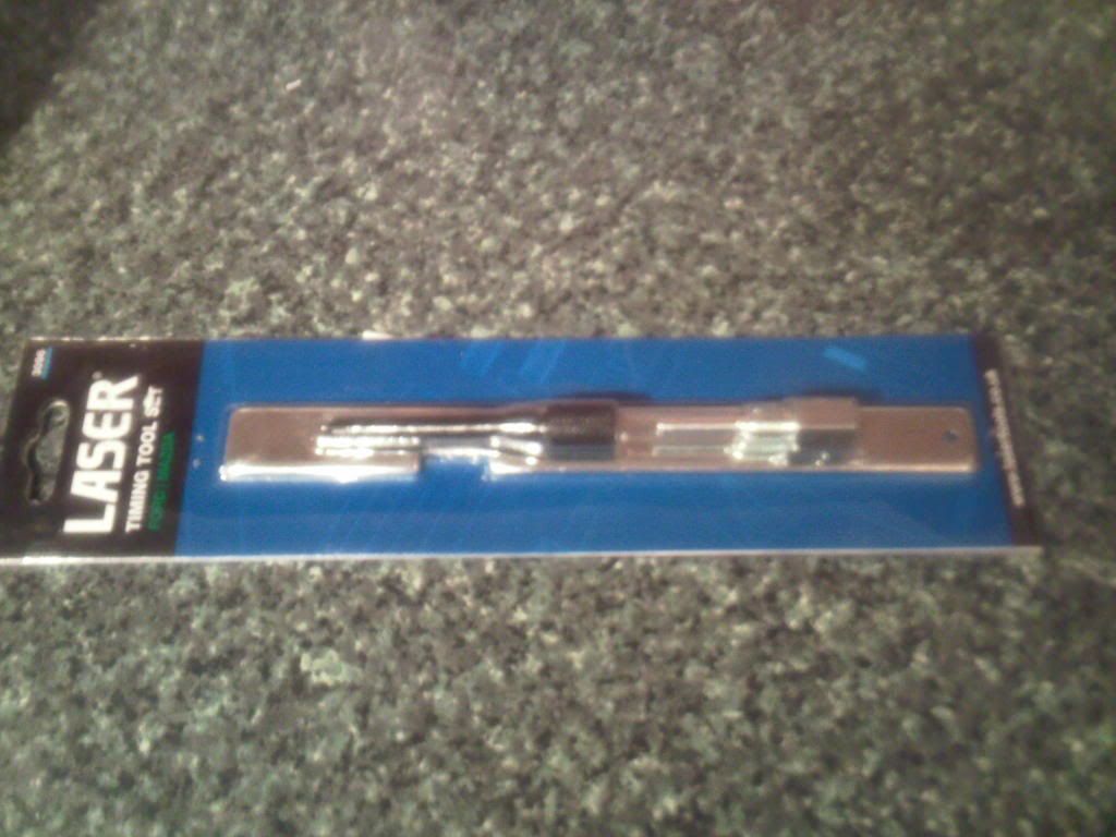

will121
posted on 21/2/10 at 07:42 PM Reply With Quote
found this web site which said 63.4 and 63.5, ive got a partly stripped zetec bottom end and measured insitue and i measured it at 63.8mm from end to face, be nice if someone could measure their's to confirm though
will121
posted on 28/2/10 at 08:32 PM Reply With Quote
just brought one the end can confirm its 63.8mm from face to end
