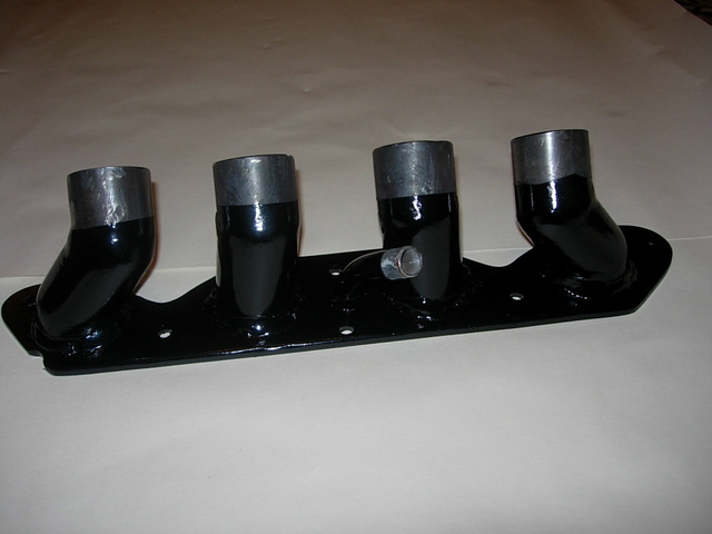

| posted on 27/2/10 at 10:05 PM |
quote: Originally posted by wrigglypig
I have just put my Pinto on zzr1100 carbs and had to do away with the return pipe from the manifold. instead i welded a small boss on the manifold
plate with an allen bolt in to act as a bleed to ensure that all the air is out and it works fine :-)
Kev
Why have you not put a pipe where you have put the allen bolt?
You could still get air locks in the head this is how i made mine
Jacko
  under view painted manifold
