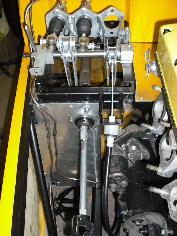

Good morning all,
With regards to my choke/accelerator cables I have bought two generic items.
I understand that a bike shop will be able to put on the ends I need, could anyone advise what I should ask for? The choke and one end of the accelerator cable needs to fit to a set of ZX9R carbs and the other end of the accelerator cable needs to fit to my pedal box as show below. It would appear I also need some way of securing the outer cable in the pedal box.

i bought a venhill cable,
It came with the bit on one end for the carbs, and then came with a bunch of adjuster and solderless nipples and clevises etc that i am going to use to attach it to my pedal.
ETA im not using zx9r carbs, but id imagine the fixing is the same on most
[Edited on 3/3/10 by Miks15]

cd.thomson
posted on 3/3/10 at 03:04 PM Reply With Quote
lol dont worry, bolts are fitted - that picture is way old but is the only clear one I have.
FYI I need a 3 solderless nipples, and a cable adjuster.
Robert, I'm going into the bike shop on saturday so I will u2u you the details of the parts I buy ready for when you're at the same stage.
