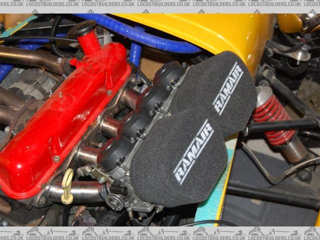

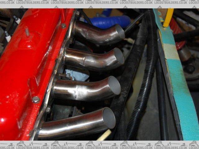

Made and Fitted Manifold and R6 Carbs.........
also got the rean lights and number plate fitted.........

Nice work

looking good ray, keep going at this rate , you will have it on the road before me.

awesome have you got any photos of how you attached the filters?

someone after my own heart that doesnt want to spend £60 on a pipercross filter.

Very nice, and most refreshing to see a manifold that doesn't have sharp 45 degree pipe joins in it.
I had a look at a bike carb manifold on the GBS/Lolocost stand at Stoneleigh, and nearly cut my finger after running it down the inside. Only
fitting a cork in the end could reduce airflow any further!

unless my eyes deceive me, enigne looks like Ford crossflow and I see that you have blocked off the waterway in the head.
any reason for that?
my understanding was that that needs to be plumbed to the side outlet of the water pump to allow water flow prior to thermostat opening.
where ahve you connected the water pump outlet?

Very tidy filters where did you get them from and how much were they ?

I got a set of them filters from e-bay £15 the pair, not bad eh
