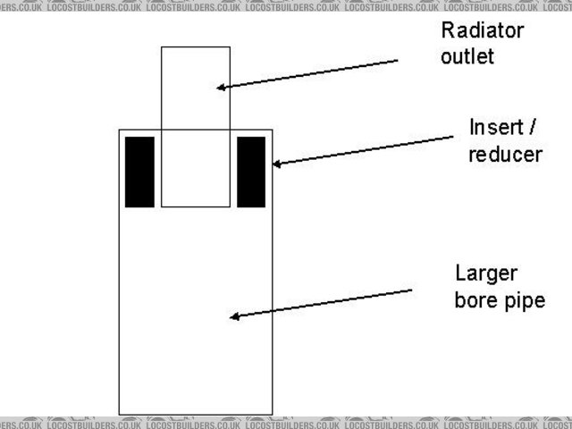

Just met a small snag, I am using a micra radiator which has 25mm outlets. My Zetec water pump has a 44mm outlet and my water rail has a 32mm
outlet.
So ideally need 1 x 44mm to 25mm 90 degree reducing elbow, 1 x 25 to 25 mm 45 degree elbow, 1 x 32 mm to 25 mm reducing elbow and some of the original
Micra hoses.
However samco don't make a 44 to 25mm reducing elbow OR any 45 degree reducing elbows.
I can just see this pipework being a complete mess of multiple joints etc. How has anyone else done this.
Or is it possible to put some sort of reducer in the end of a larger bore pipe. If so I will just buy some of those flexible pipes and do
this.
wicket
| posted on 18/5/04 at 01:30 PM |
Proven Products used to list a 45 to 25mm straight reducer if thats any good.
http://www.proven-products.co.uk
splitrivet
| posted on 18/5/04 at 02:04 PM |
How about a plumbers merchants they are both standard water pipe sizes.
youd probably have to use a short piece of 25 mill hose to connect tho.
Bob
James
| posted on 18/5/04 at 03:22 PM |
I've just gone through this to connect a Pinto to a Micra rad.
I sourced all the bits to do it with copper pipe- even used York fittings or olives so as to give the jube' clips something to go around. Even
convinced my mate who's a plumber to come and solder them for me.
After all that though it was easier (and nicer lookin) to TIG weld my own out of stainless! I took the smaller piece and splayed the end out somewhat
and then bent in the edges of the larger piece of tube. Once the two fitted together nicely I just TIG'd them together. Put three blobs of weld
around the hose end to give the Jubilee clip something to hold against.
HTH,
James

givemethebighammer
| posted on 18/5/04 at 09:54 PM |
wicket - whereabouts on that site was the reducer I couldn't see it. Thought standard water pipe sizes were 28mm and 22mm ? might be wrong.
Thanks given me some ideas to go on
splitrivet
| posted on 19/5/04 at 10:25 AM |
They are, but they are internal pipe diameter, so a 22 mill solder fitting is roughly 26 mill outside diameter give or take, youve got the pipe wall
plus the fitting wall to take into account. As James said he got fixed up out of the back of his mates van so a proper plumbers merchants with a shelf
load of reducers bound to have what you need.
There is a bigger size than 28 mill but cant remember the exact dimension.
Bob
[Edited on 19/5/04 by splitrivet]

givemethebighammer
| posted on 20/6/04 at 08:16 PM |
Got this sorted with the help of my friendly local engineer (actually a job on the side when his boss was out )
Two very nice machined reducers one 44mm to 25mm and one 32mm to 25mm..
