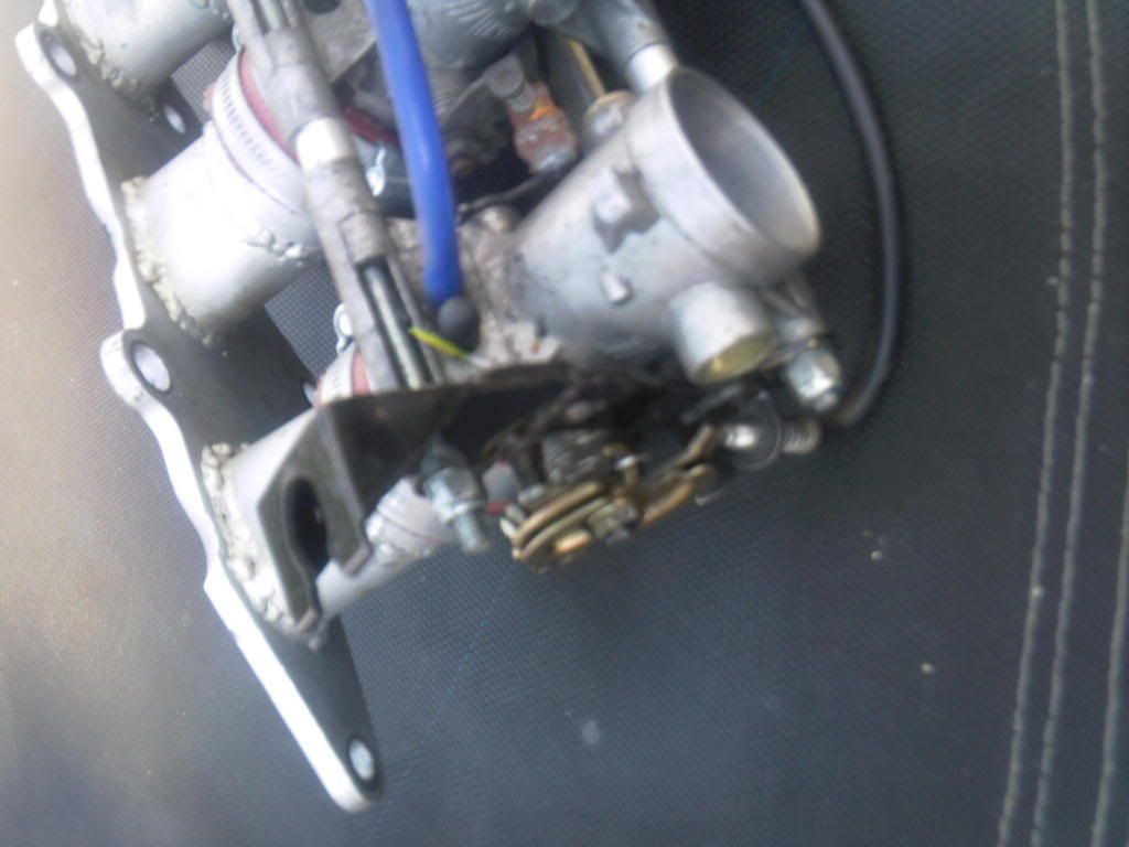

Hi all, i put my honda fireblade carburettors onto the side of my 2.0l pinto the otherday and got it running well (sounds fantastic) but i'm now struggling to figure out how to mount a throttle cable to them, Anybody got any ideas? The car is a ford Capri and i'm itching to sort the cble so i can take it out for a blast thanks

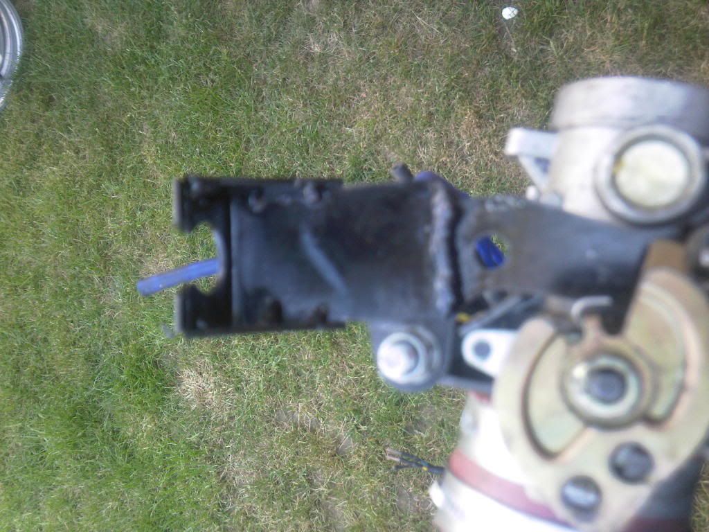

ive always prefered to modify the orignal car throttle cable and use that if possible, may have to enlarge the nipple hole and make bracket arrangement to clamp the outer cable, will try get some pictures up
