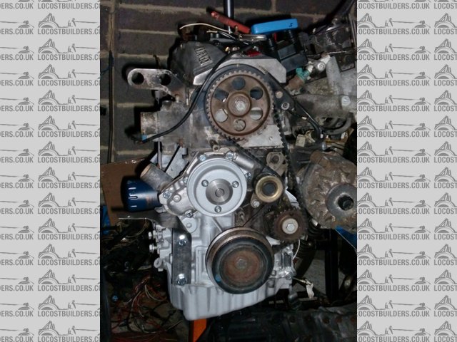

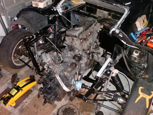

MakeEverything
| posted on 11/7/10 at 10:54 AM |
UPDATE.... Now with Photo
  Engine In.
Kindest Regards,
Richard.

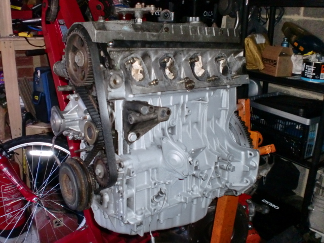

MakeEverything
| posted on 14/7/10 at 05:30 PM |
Well, i was "working from home" today, and look what the garage fairies did for me....
Somehow i got covered in oil and grease too??? That little steamer worked a treat getting the engine clean...... apparently....
  Clean Engine 3
  Clean Engine 2
  Clean Engine 1
:thumb:

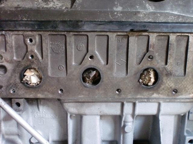

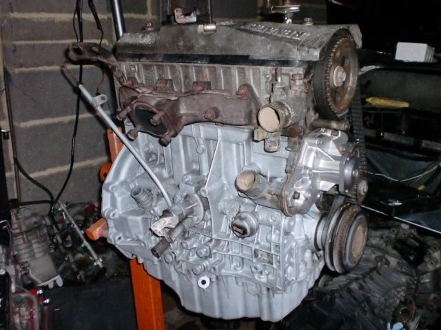

MakeEverything
| posted on 16/7/10 at 12:50 PM |
Last night i was working away removing the old exhaust manifold studs in preparation for the new ones to arrive, and the inevitable happened....
The last bolt sheared off flush with the head.
This morning i got straight to work with the drikk and tap, and this is the result.
  Studs Extracted
Happy days!
Kindest Regards,
Richard.

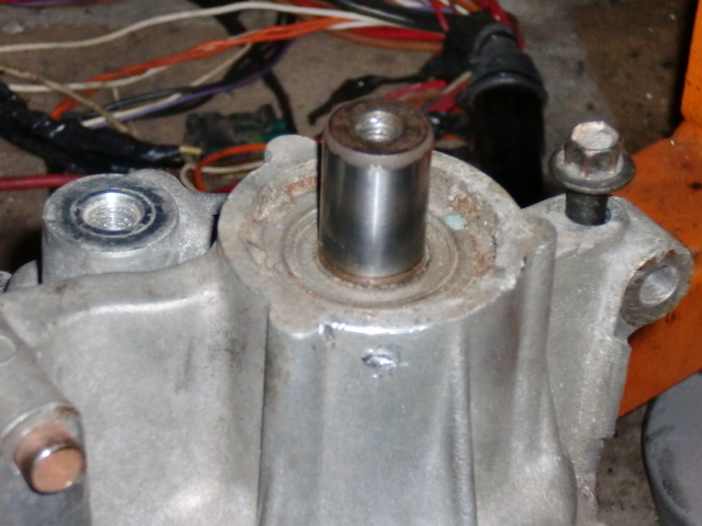

Following a coupleoffailed botch jobs at getting it off, i finally removed the supercharger pulley with a set of 50 year old pulley removers and some
brute force and ignorance.
As suspected, the pulley seems to have been heated in an oven, and shrunk onto the shaft. It was incredibly tight and needed one hell of a lot of
force to get it off. The pulley was steel after all, not aluminium and i was surprised considering that the pulley was almost brand new. This is
quite comforting though, as this means that the supercharger has had little or no use.
Dont listen to anyone else give you a load of old crap about a special tool for the eaton supercharger. Just a normal pulling tool (Heavy duty tho)
will do.

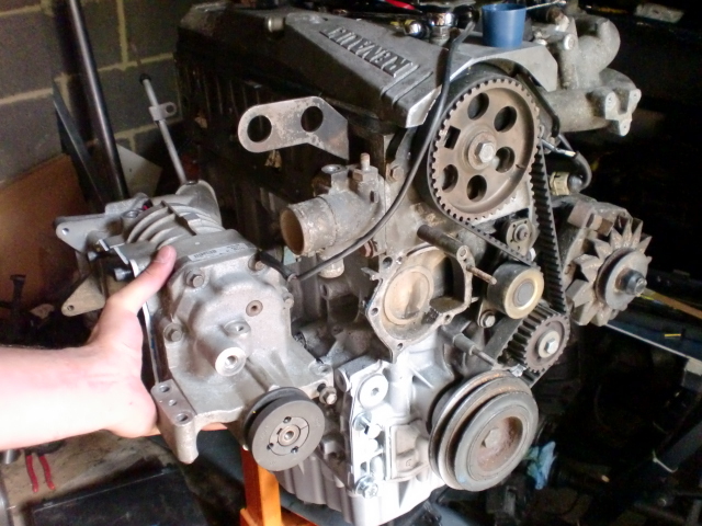

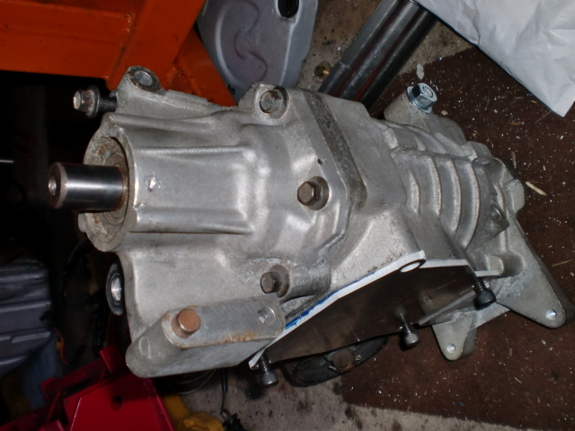

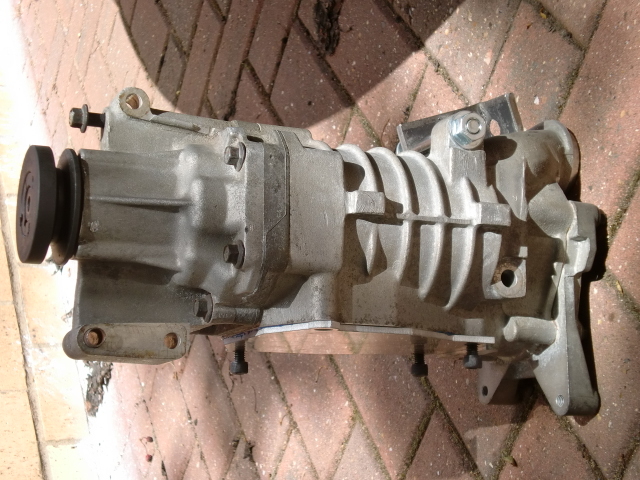

MakeEverything
| posted on 21/7/10 at 01:50 PM |
After breaking the first taper lock trying to shoe-horn it onto the shaft (too small) i ordered a larger one with a 20mm bore yesterday. It came this
morning, so i fitted it this afternoon.
These are the results. Sorry about the poor top photo. Its heavy to hold with one hand and take a photo at the same time!!
  Supercharger Mount
  SC Pulley on
Kindest Regards,
Richard.

MakeEverything
| posted on 21/7/10 at 06:05 PM |
Looking even better now!!
  Charger Mock Up 1
Kindest Regards,
Richard.

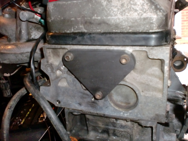

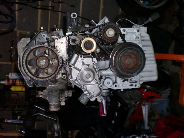

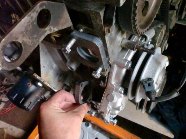

MakeEverything
| posted on 21/7/10 at 09:03 PM |
Progress.....
One of the bolts is very loose on the far LHS of the pump, so although its loctited in, its not doing much. Im hoping that the other bolts and the
gasket will do their jobs! I know its not ideal, but i may look at something later on before the engine goes in for final fitting.
  Water Pump on
Oh, and in my attempt to TIG weld some steel brackets so that i can take some accurate measurements, i dicovered that the steel that i WAS going to
make engine mounts out of, doesnt weld!!! Just as well i was talked into using the OEM ones!
Kindest Regards,
Richard.

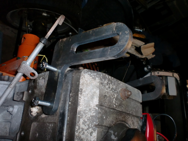

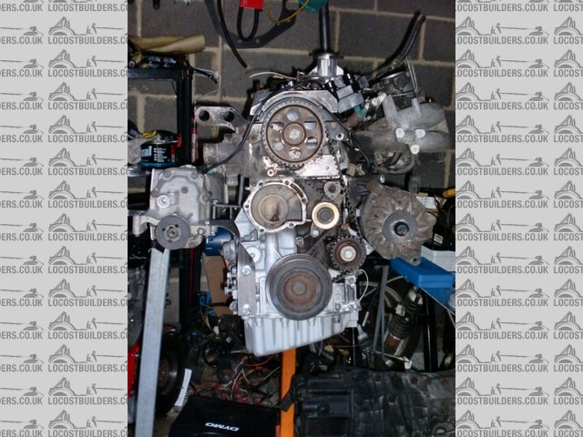

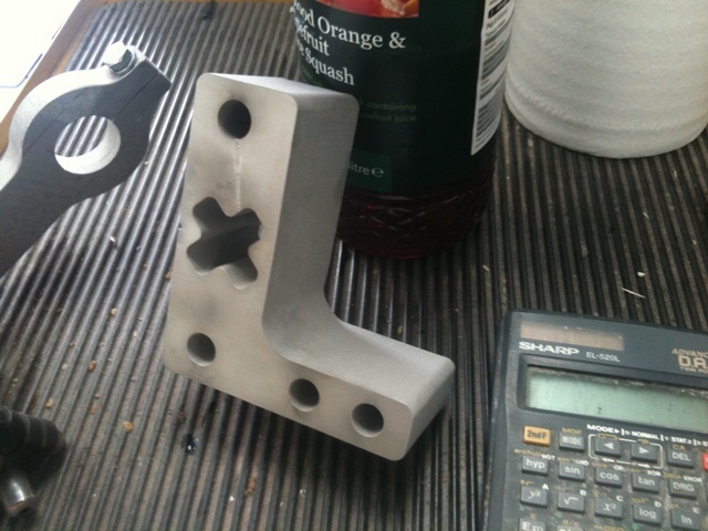

MakeEverything
| posted on 22/7/10 at 09:32 PM |
Cheers Ian,
Just getting some Ali cut for the front bracket, and i'll make one for the rear once it arrives. The front wone will look like this;
  Supercharger Bracket
Kindest Regards,
Richard.

Also, i had a text message from the same guy, who managed to cut my supercharger front bracket for me!
  Supercharger Bracket cut

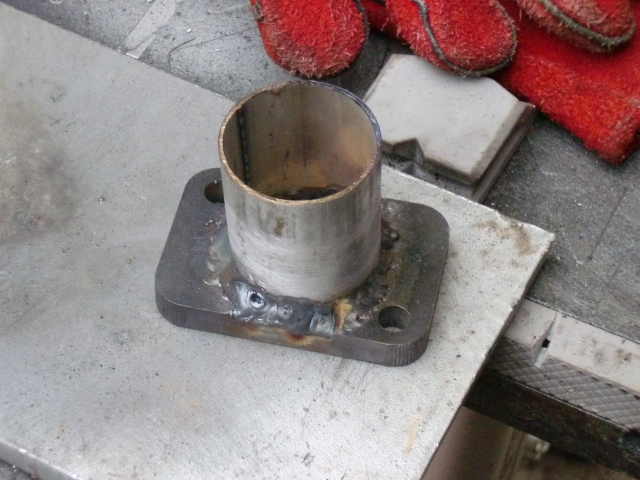

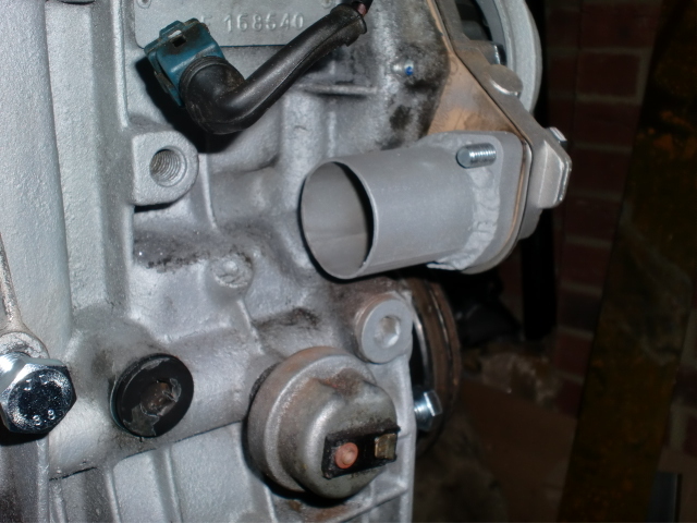

MakeEverything
| posted on 24/7/10 at 07:17 PM |
Managed to get the TIG welder working better again, and penetrating the thicker metal. Didnt have enough amps for the other stuff!! derrrr,
schoolboy error!
This is the result of the bottom hose;
  Bottom Hose Welded and Fitted
Sadly, i managed to get the top hose done first but spot the error.....
  Top Hose SPOT THE ERROR
I need to get another and try again!
Kindest Regards,
Richard.
Angel Acevedo
| posted on 26/7/10 at 11:57 PM |
Welded on the wrong side!!
MakeEverything
| posted on 27/7/10 at 06:21 AM |
Afraid so! Got another one coming, rather than grind it off, as the surface needs to be flat.

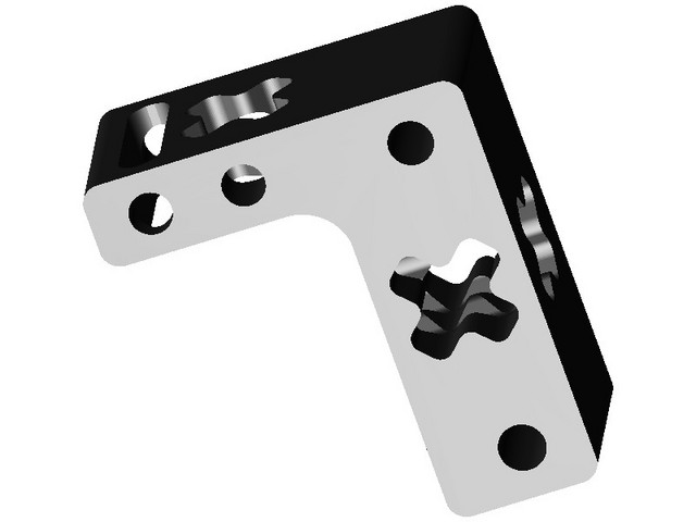

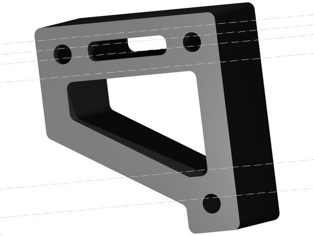

MakeEverything
| posted on 27/7/10 at 06:24 AM |
The new bracket arrived whilst i was out this afternoon, but i wasnt too sure about it. I think maybe it looks a little too "XBOX" rather
than anything else. So ive redrawn the bracket to look like this;
  Another bracket
It's a little bit conservative, but should be cut tomorrow and delivered before friday. This will give me a mounted supercharger at the weekend
im hoping!!!
Kindest Regards,
Richard.

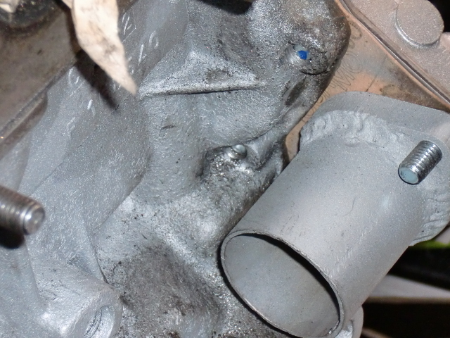

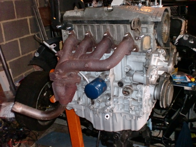

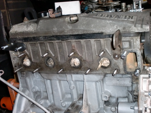

MakeEverything
| posted on 27/7/10 at 09:09 AM |
Finished two niggly little jobs this morning. Its surprising how much you can get don in just 30 minutes of 'garage time'.
Helicoiled the water pump bolt that had stripped. All good.
Fitted the exhaust manifold bolts that arrived today, with the helicoil set and 3 pin plug for the Lambda sensor.
  Helicoiled
  New Exhaust Studs
Next is the new supercharger bracket (when it arrives) and the alternator lower bracket that i bought the other day.
Kindest Regards,
Richard.

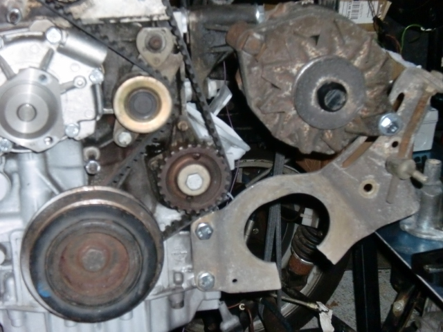

Also, in the 10 minutes i was out there, i grabbed the grinder and cut the alternator bracket off of the power steering pump. I need to remove some
of the excess metal and strengthen it again, but it looks good so far.
  Alternator Bracket
As i said, its surprising how many little jobs you can get done with the odd 10 minutes here and there.
