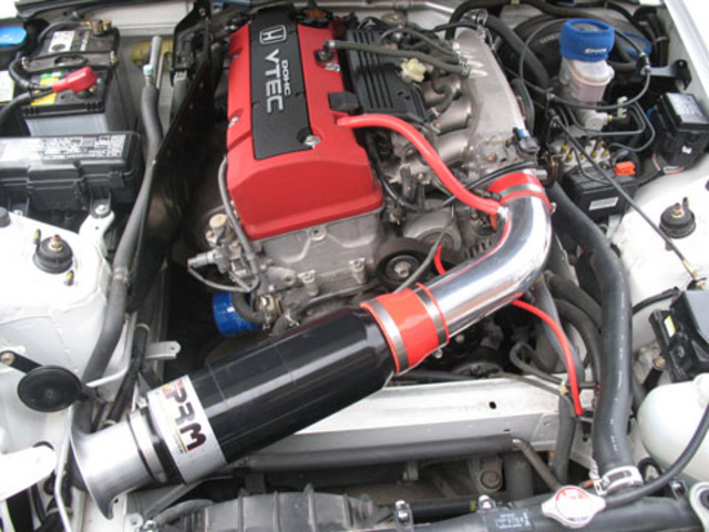

something like mine on my f20c would be good i think
my new intake
my new intake

I'm not sure what you mean!? Its just a way of mounting the filter I need not another one
^that does look nice though but fitting it in a small chassis might be another thing.
daniel mason
posted on 9/9/10 at 04:54 PM Reply With Quote
i was meaning the solid link pipe wit a jubilee at each end!
that way it cant move the filter as its not flexible.
