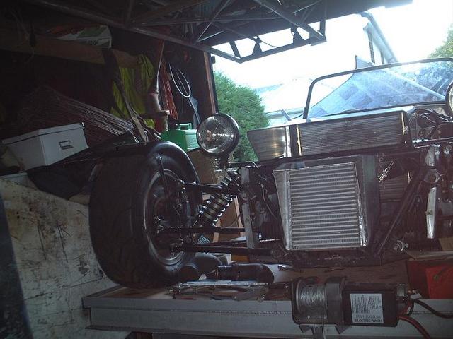

MR2 turbo intercooler mounted on a Polo rad.
  Intercooler mounted

| posted on 15/9/10 at 07:11 AM |
That MR2 is a nice unit by the looks of it. Too many OEM intercoolers are wider than they are high which isn't exactly good for pressure loss...
(though it is cheaper).

| posted on 16/9/10 at 12:30 PM |
As good as charge coolers can be the MR2 intercooler is cheap and light and I was running 270BHP and 1 bar boost through it.
I did add cowling as can be seen below which obviously helps. I also added cowling to the intecooler to trap air in front of it. Air flow out of the
engine bay is just as important to reduce pressure behind the rad.
I saw a comparison of OEM intercoolers which included the style I used (Toyota used them etensively) and they work OK but not as good as properly
shaped end tanks. Good enough for the money though.

coyoteboy
| posted on 16/9/10 at 01:39 PM |
Wholeheartedly agree that the MR2 intercooler is actually very good (or an ST185 celica gt4 one if you want entry and exit on different ends) . And in
accordance with the post above, one of the biggest differences you can make to an intercooler is a cowling around its intake end. If you can trap the
incoming air and force it to go through the IC it can work multiple times more efficiently than if it has open sides. I see a lot of barried up cars
with FMICs 5ft wide across the front with no cowling or ducting of any sort and think "you might as well have halved the size, cost and thought
about it properly" but I guess looks is part of it for them.
