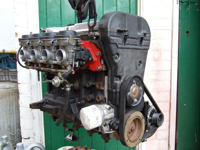

| posted on 7/10/10 at 02:38 PM |
I had to mount mine on the exhaust side and copied an adjustable bracket from someone on here
  Alternator bracket
  alt bracket 2
  alt bracket 3
Regards
Rob
| posted on 7/10/10 at 03:06 PM |
Silvertop set up above..
This is my blacktop set up using the alternator as a tensioner.
| posted on 7/10/10 at 03:08 PM |
And this was my first attempt for the previous silvertop engine...
chris-p-duck
| posted on 8/10/10 at 03:19 PM |
thanks folks. Those photos have really helped me get my head round things. Have you had any issues using the adjuster brace as opposed to a spring
tensioner?
