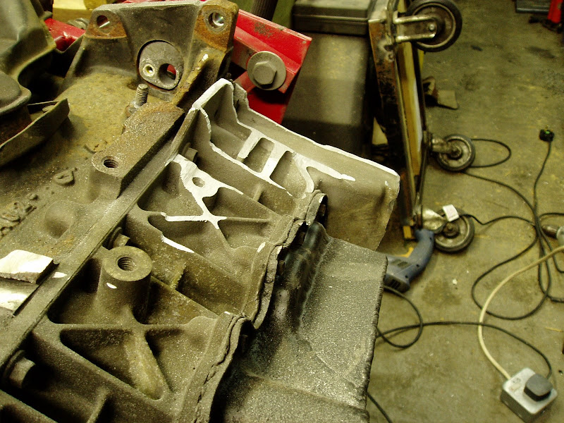

| posted on 3/11/10 at 12:18 PM |
This is how much I took off to suit the DOHC starter...
