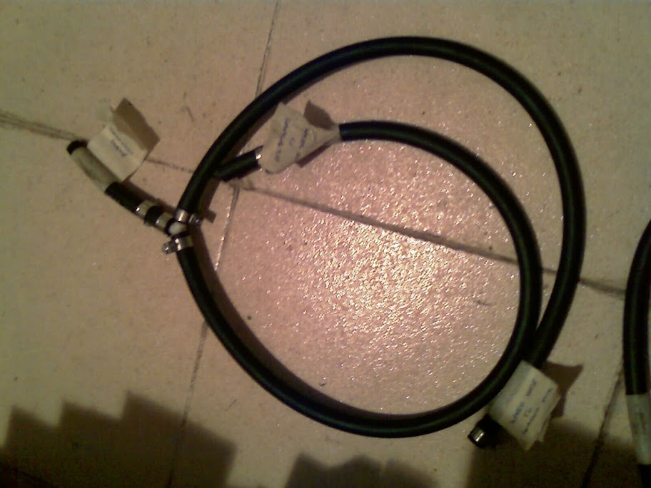

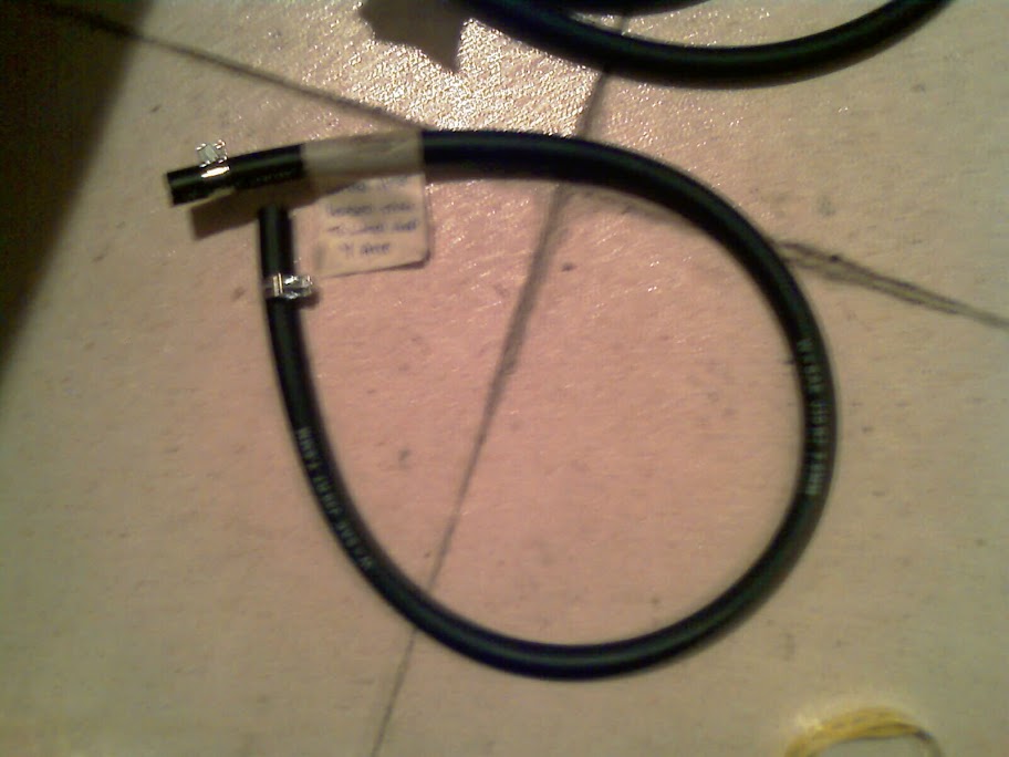

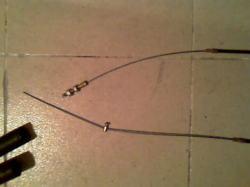

| posted on 14/11/10 at 09:11 PM |
Hello, IanL!
As promised, here go the measurements.
The throttle cable is 175cm long from end to end of the cable. Note that the sleeve the cable runs in is shorter that that.
The water pipes are more than just two... So I measured them all and took pictures of some.
1) Thermostat to radiator top via temperature sensor (remote) - 61cm of 3cm diameter pipe
2) Y piece from water pump to radiator lower - 101cm of 3cm diameter pipe
3) Header tank to water pump Y piece - 80cm of 1cm diameter pipe
4) The white plastic y piece has three pipes of 1cm diameter. The 14cm one goes to thermostat "headsink(?)". The 66cm one goes to the
header tank. The 78cm one goes to the radiator top.
I hope this makes sense to you, it still doesn't make to me
Happy building!
