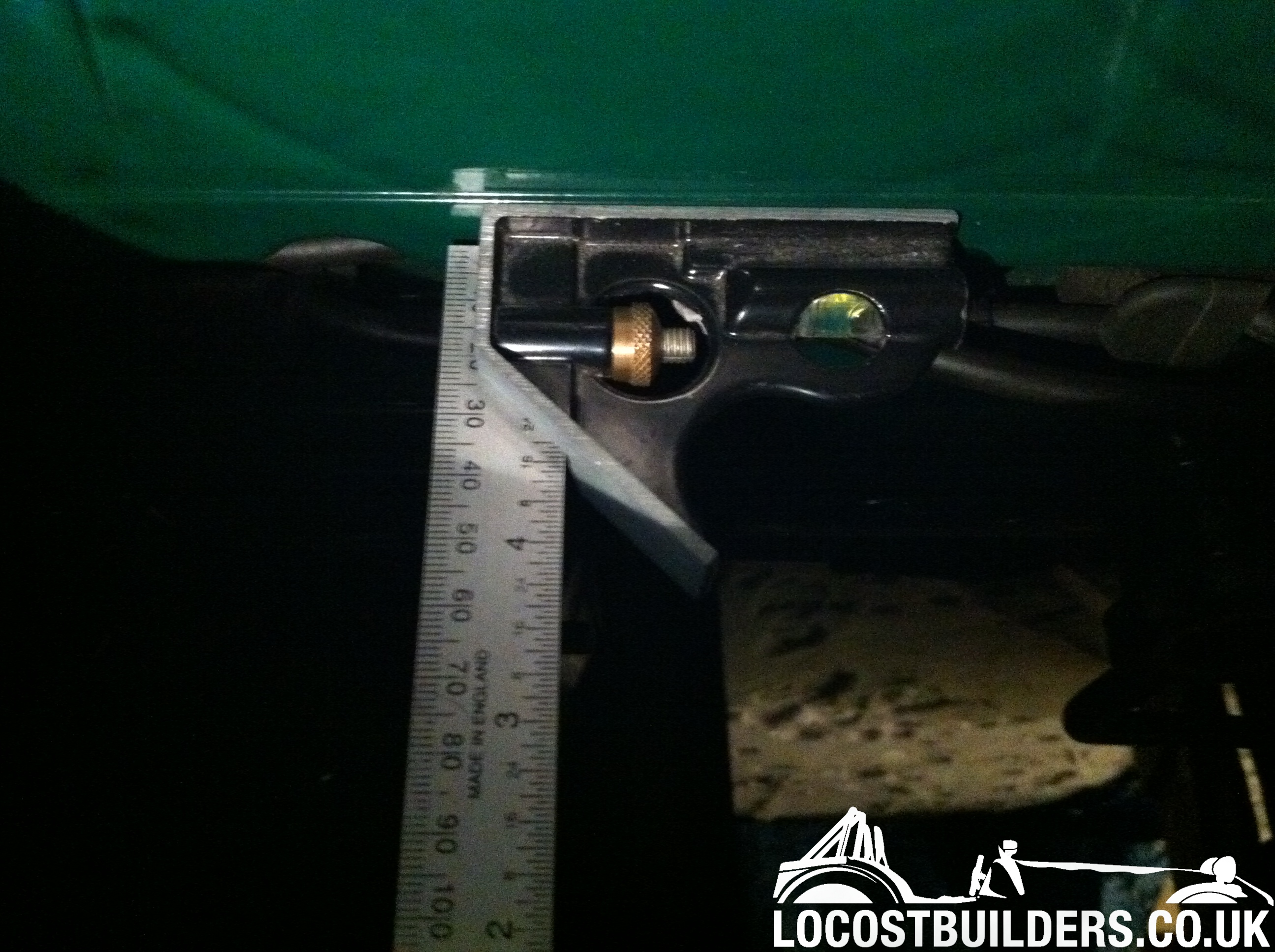

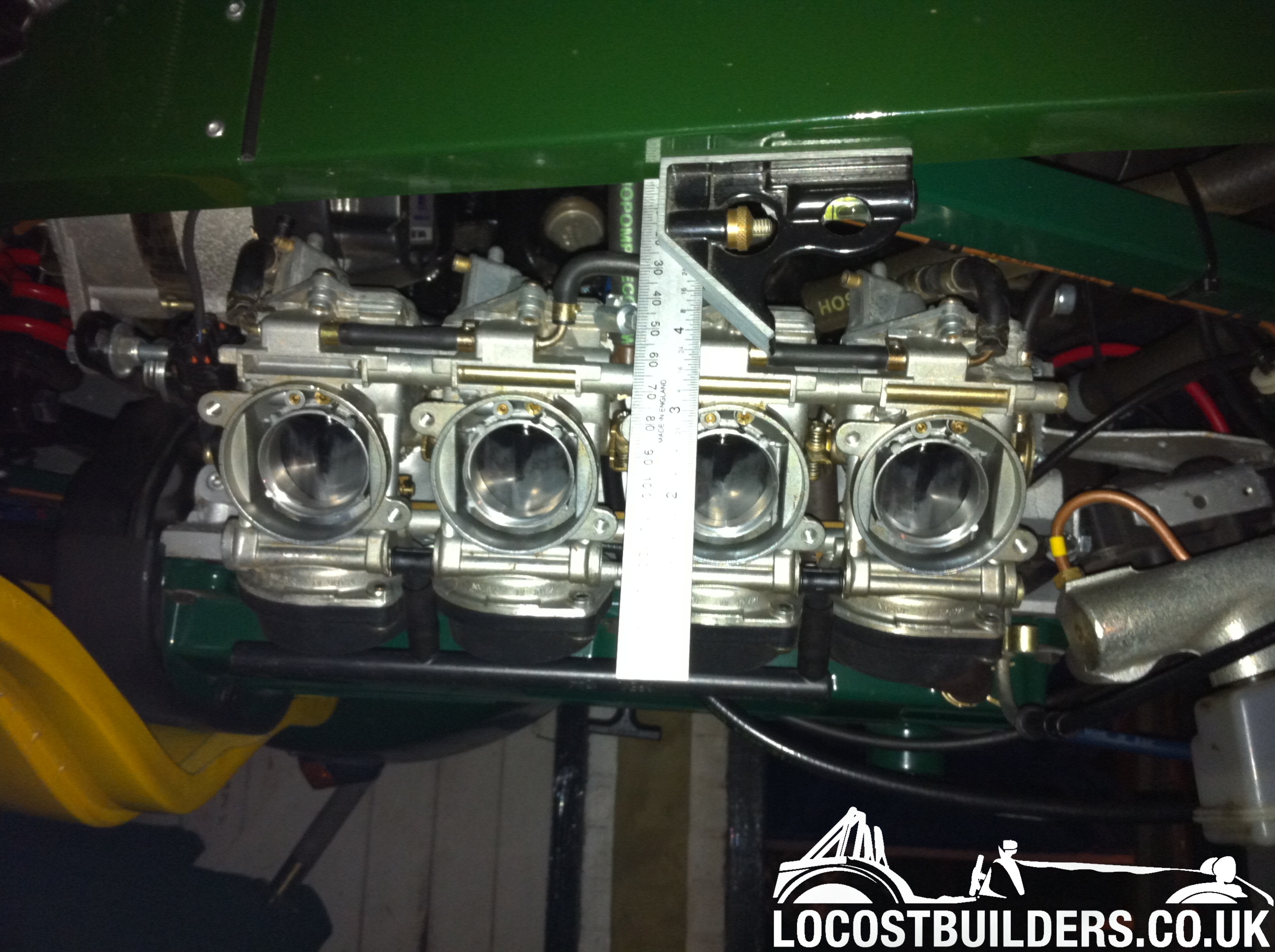

Right I checked and the engine is lower at the front as shown here: http://locostbuilders.co.uk/upload/IMG_0229%201.JPG
and
http://locostbuilders.co.uk/upload/IMG_0225%201.JPG The car is a Tiger Supercat so I don't know if this is by design or not. It was built by a reputable builder and has had this angle since I bought the car....
