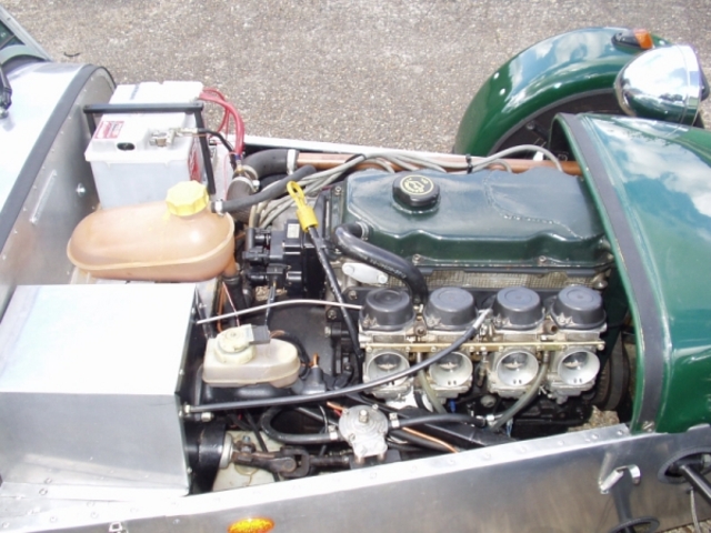

Surrey Dave
| posted on 7/12/10 at 02:28 PM |
[img][/img]
Surrey Dave
| posted on 7/12/10 at 02:30 PM |
The car now has Megajolt ignition with Zetec coilpack on the back of the engine.
My exhaust is the standard cast manifold but i mad my own 2 into one section that comes out through the body work, with quite long pipes aimed at
giving good torque.
don't let the detractors sway you too much from this motor it's cheap,low maintenance and quite respectable performance with the bike carbs
and Megajolt, i've had a 2.0 Zetec waiting in my to swap over for about 4 yrs ,it never seems worth the hassle.......
[Edited on 7/12/10 by Surrey Dave]

Surrey Dave
| posted on 7/12/10 at 02:55 PM |
1st Downpipe I Made
handyandy
