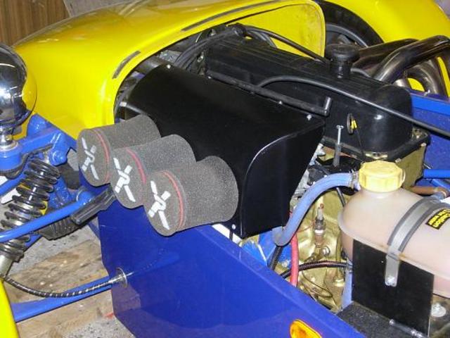

I used these on my ZX 9 carbs picked them up for £15.00
RAMAIR tall carb air filter socks Weber DCOE Dellorto on eBay (end time 08-Jan-11 12:25:30 GMT)

posted on 7/1/11 at 07:04 PM Reply With Quote
ah, just seen that yeah^
the ramair ones linked above look a better size. are the reinforced with wire inside to hold the open?
i'm quite tight on space for them, but i want to run the engine. once i know everything works, i can look at a air box, but for now, they'll be fine
i've got the trumpets with back plate, cable ties seem the way, think i can see a good way to do it
thanks
