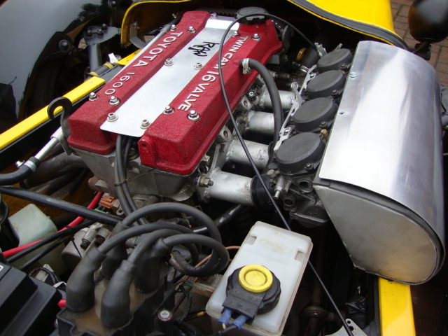

As above Aerosol is fine
Did these with Plastikote Super Enamel

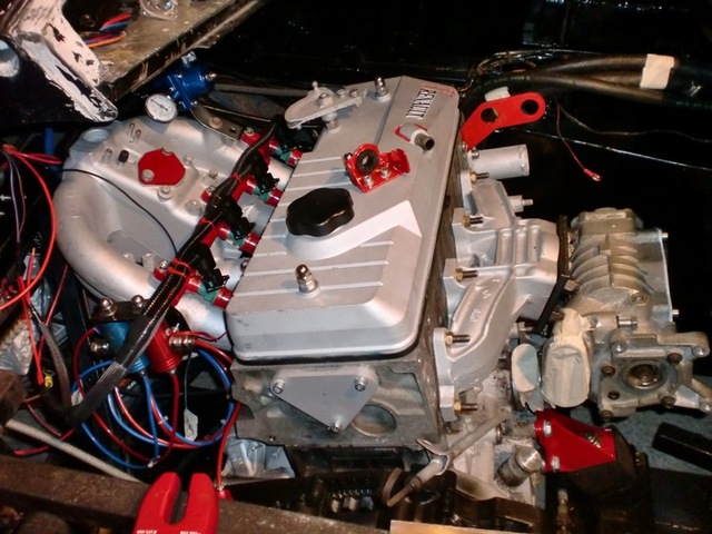

Did mine with VHT Engine paint.
