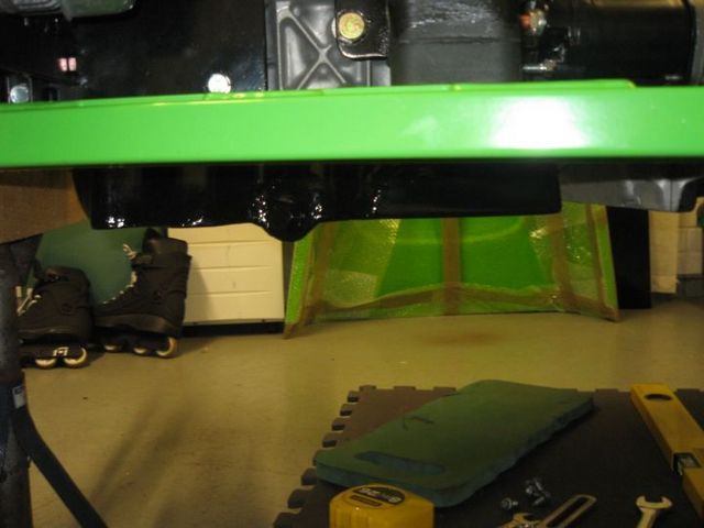

jacko
posted on 5/2/11 at 09:02 PM Reply With Quote
NO I think dunk3 had to remove about 40mm off the std steel sump
this is Dunk3 car

whitestu
posted on 5/2/11 at 09:31 PM Reply With Quote
Yep, you'll need to cut a blacktop sump down to fit an Indy and give enough ground clearance.

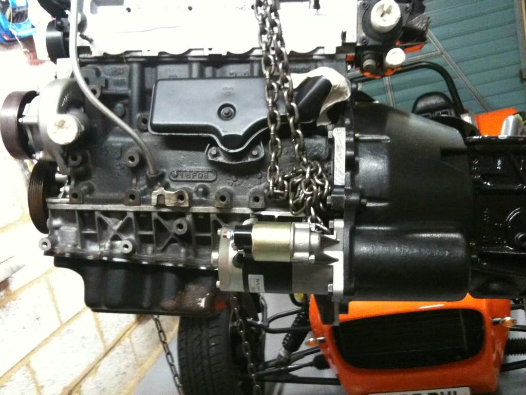

RichardK
posted on 5/2/11 at 10:27 PM Reply With Quote
Originally posted by jacko
You will have to cut the alloy away for the starter too
Have a look at Dunk3 photos it's very helpful
Jacko
Starters already on!
