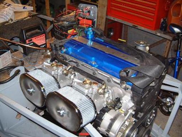

pic

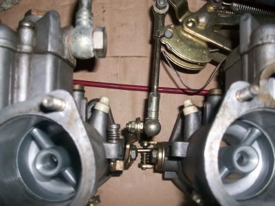

OK! Pics at last....
Old CVH manifold on the top, new zetec manifold underneath. The two main difference are the hole between port 2 and 3, and the fact the spacing between 2 and 3 in wider. Will grinding out the centre section be ok? or cause any issues?
and the linkage pic. the problem is that the two carbs will now sit too close together so the rod that pushes down on the spindle fouls a mounting lug on the side of the carb body.
Any thoughts? reccomendations? Different linkage? different manifold?
