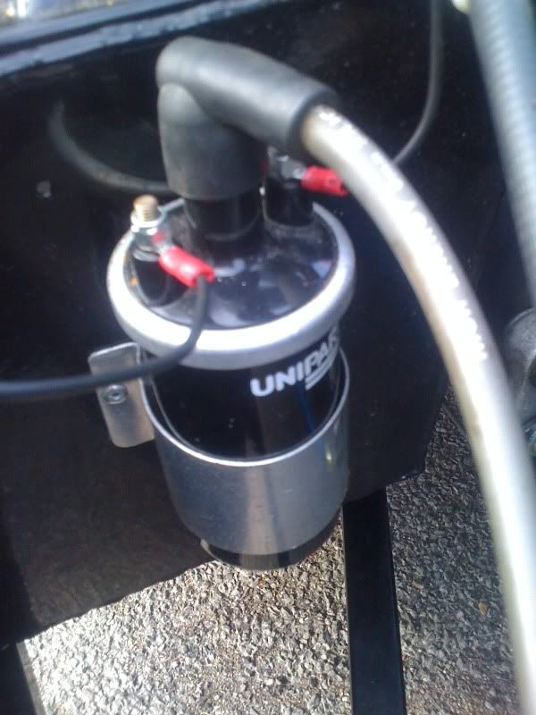

I have a unipart coil.
The coil is currently wired direct to the battery while testing, and then obviously king lead to dizzy, ht's to sparks.

Presume you have connected positive lead of coil to the positive of the battery and the negative lead of the coil to the distributer contact breaker?
If you have wired both terminals of the coil to the battery a) that won't work b) the coil will cook...

Oops, you might have cooked your coil. If you have a points distributor and you leave it standing with the points closed (quite likely), your coil is effectively connected directly across the battery. It is not designed to carry a full continuous current.
This is why a) you should feed the coil from your ignition switch, and b) you shouldn't leave the ignition switched on for too long without the engine running.
Feeling the coil temperature by hand isn't a good guide. Once he coil gets above about 60 degrees C (again quite likely) it will be too hot to touch. The coil is meant to get hot, but as I said it shouldn't be left connected as you have done!

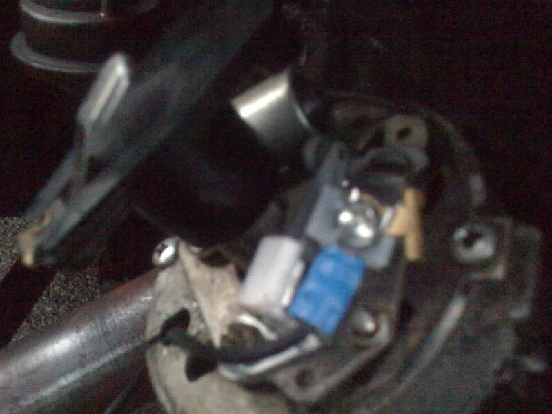

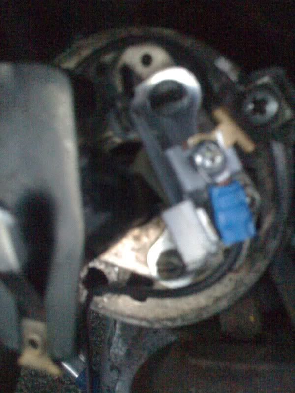

Just wanted to confirm that i have linked the neg of the coil to the right place:
adithorp
posted on 21/3/11 at 07:37 PM Reply With Quote
Appears to be correct but it's a bit fuzzy. Have you set the points gap?
