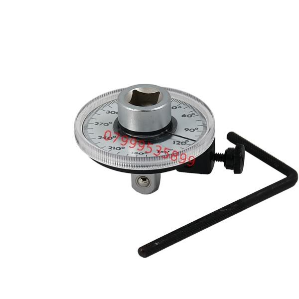

Tools wise just over a tenner will buy you the proper cam tools and the zetec is a nice easy engine to work on. Only other special tool would be an e10 female torx's bit for the cam caps and an angle gauge for the head bolts gives peice of mind.

Professional Quality Torque Angle Gauge 1/2' Drive on eBay (end time 28-Mar-11 21:08:47 BST)

Thanks mate, got everything except the pin kit then, just ordered it so thanks for the link.
