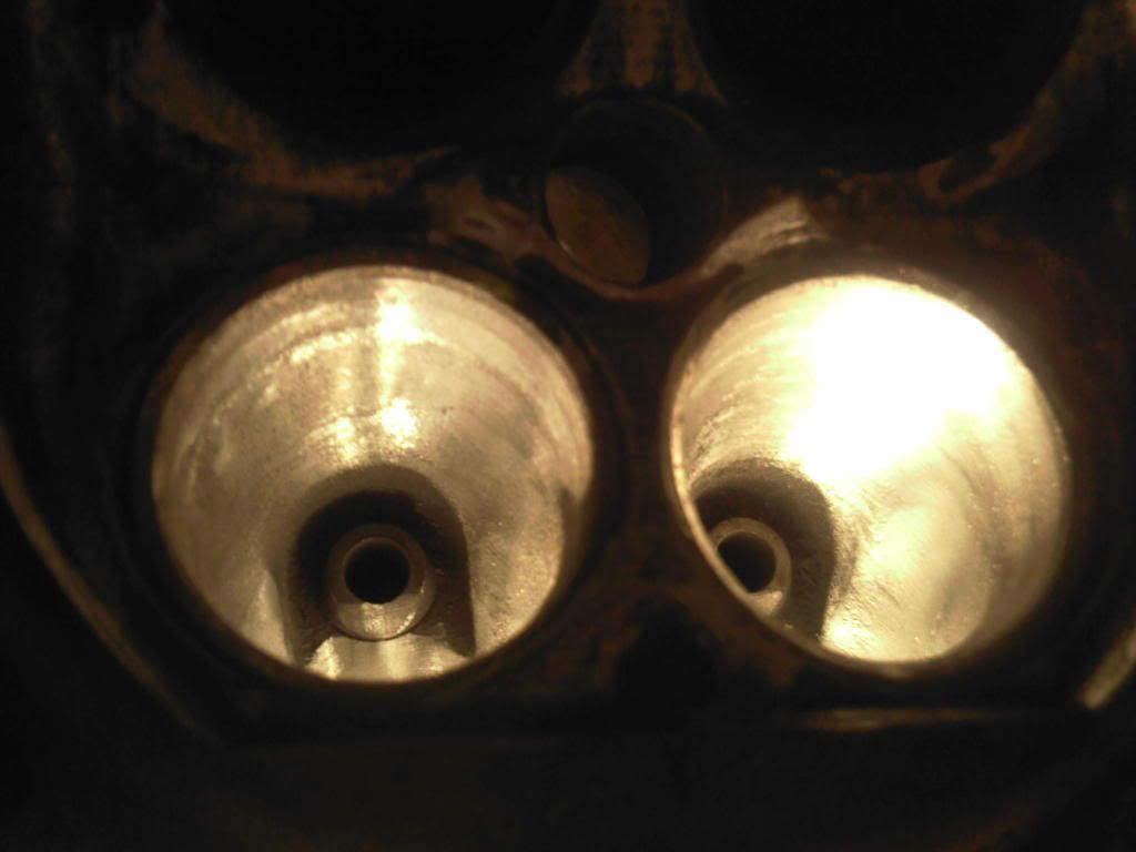

whilst i accept there is skill to profesionally porting a head for best flow which you pay good money for i basically cleaned up the ports opened up the back of the valve seat and knife edged the port bridge, lots of pictures some where, i am in the process of doing a spare head at mo.

Will, is there any chance you could upload some of these pictures please?

these are some of the pictures of my first head currently fitted at 173bhp with newman 270 cams, its a good spread of power but would have liked bit more could have gone with 285 kent cams, current head im doing have spent bit more time on it but not got any pictures yet

That looks like some good work. How easy is it strip the head down?
