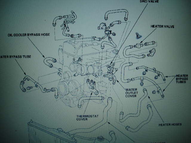

posted on 30/3/11 at 10:29 PM Reply With Quote
so if my bottom header tank hose goes to the bottom rad hose. can i pipe my top header tank hose into one of the hoses at a high point on the engine? thanks for the help by the way
daniel mason
posted on 30/3/11 at 10:39 PM Reply With Quote
here is a picture of the s2000 cooling system
posted on 30/3/11 at 10:40 PM Reply With Quote
thats right. basically, the header tank connections should go to the highest point of the cooling system to make sure no air can get trapped in the cylinder head.
the top connections on the tank are there to get air out the engine and radiator
daniel mason
posted on 30/3/11 at 10:45 PM Reply With Quote
so with my large bottom header tank hose teed into the bottom rad hose, which of the hoses in the diagram would you tee the top header tank hoe into?
posted on 30/3/11 at 10:55 PM Reply With Quote
i always struggle to work these diagrams out, but generally, whichever is at the top of the cylinder head.
if you look at the diagram though, the pressure cap in on the radiator, so usually, thats at the top of the system, and thats it. maybe worth a u2u to pwl if he's done it already. where's the water outlet cover? if that on top of the cylinder head i'd go with that. my engine is designed to run with a header tank though, so its easy, but yours isn't really
daniel mason
posted on 30/3/11 at 11:07 PM Reply With Quote
If you look carefully at the diagram the top rad hose goes into the outlet cover. It's labelled on it but the writing is small
