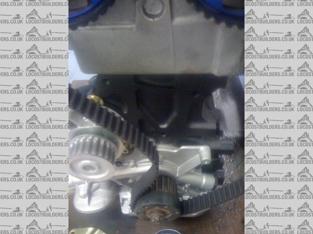

I decided to run without the belt covers and made a schoolboy-error by binning the 'back-plate' which has the mounts for the
belt-tensioners.
Are there any widgets for attaching the belt-tensioners directly to the block, or do I need to find another 'back-plate'.
Sorry for the cr*p photo...

Sorry, are you missing the back plate that the spring on the tensioner attaches to ? or the posts that the tensioners sit on ?
| posted on 19/4/11 at 07:39 PM |
Both...
It's Evolution Baby!
perksy
| posted on 19/4/11 at 07:46 PM |
Afraid you need the 2 posts for the pulleys
The tension spring you can get away with and these have a reputation for breaking anyway
Some folks have had the remains get in betweeen the crank pulley and cam belt
Worth asking on Migweb if anybody has some Posts available or its Autovaux or get some spun up on a lathe
Why not convert to steel non-adjustable pulleys and tension the belt off the water pump ?

Cheers... can you buy the posts on their own (i.e. no backplate)?

Are these the babies I need!?
VAUXHALL 20XE 16V CAM BELT TENSIONER PULLEY SPACERS | eBay UK
perksy
| posted on 19/4/11 at 08:59 PM |
Yep
Be worth trying Autovaux first though as they *might* be cheaper
stevepj
| posted on 19/4/11 at 09:02 PM |
Got a spare set in the garage, send me your address and will stick them in the post to you
