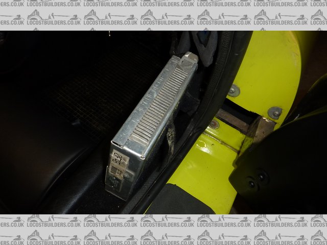

The EDIS module is conected to an electronic box with the Ford logo on it, 6 inches square by 1 inch thick which I suspect is a basic form of ECU?????
Could I just conect the megajolt ECU to the EDIS????
Brian

sounds a bit strange - got any pics ?

I have a couple of pics but cant seem to find a way of posting them
mcerd1
| posted on 21/6/11 at 11:31 PM |
^^^ just open them in your archive and copy and past this bit of text into your post
like so:
  ECU???????
  ECU?
it does look like a standard ford ecu, I wonder if its just had the fueling part dissconeted (sort of like an unprogramable version of megajolt...)
but what ever it is you can just replace it with a megajolt ecu (or similar) - in fact the EDIS4 will run a static 10 deg. advance with no ecu at all
(fords limp home mode)
[Edited on 21/6/2011 by mcerd1]

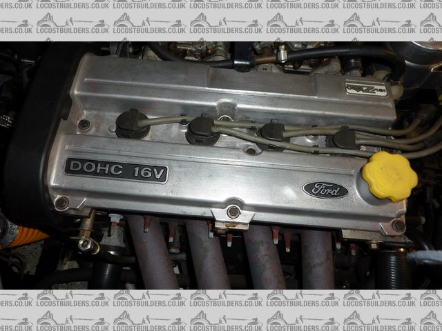

Just to make sure I do have an EDIS
Also some of the engine, I have searched for a engine number but all I can find is the following 928M-6015-CD
and dont know which model of car the engine came from.
Anyone have an idea of model it might have come from?
Brian
mcerd1
| posted on 22/6/11 at 04:49 PM |
its a "silver-top" zetec - the one that was in all the 16v escorts and mondeo's in the mid 90's
(the black-top version replaced it by the time you get to the focus's - these have a black plastic cam cover)
yes that is a EDIS (the 4 means 4 cylinder)
and you do have a toothed wheel - its built into the flywheel (the zetec used this setup as standard)
its on the engine side so you cant see it even with the gearbox off
the sensor is down the side of the block, in the flange that the bellhousing bolts to - it should have a sheided wire running directly to the EDIS
