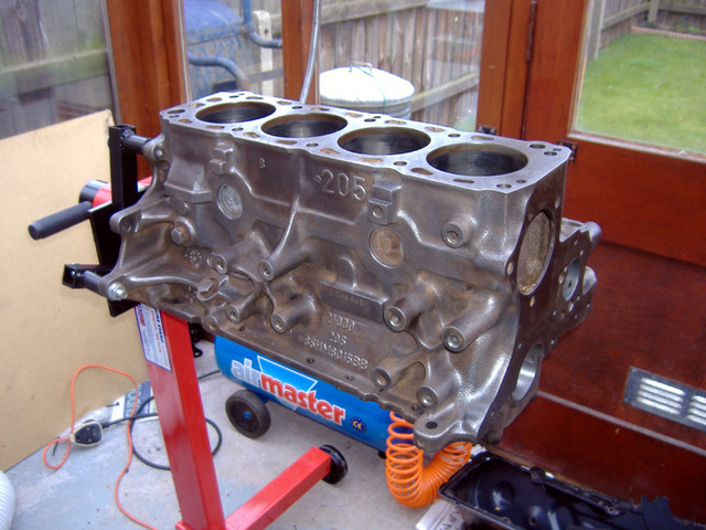

Number is stamped on to a machined face about 1/3 the way up the block on the drivers side, toward the front.
IIRC its about 6-8 characters long.
You'll see the pad on this pic
Between the 2 sets of 4 bolt holes. Cast in numbers below and stamped in on the flat part.

Cheers thats the engine number sorted! Was covered with a thick layer of horrid red paint.
So engine Number at top stamped in, The number below that Defines the date,
Any idea why the one on the head under the rocker cover is different, is this standard, or could it just be that the head was replaced?
