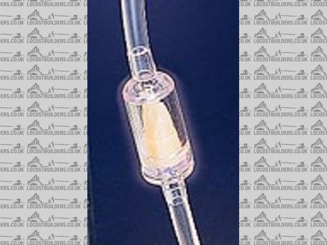

aquarium shops sell little plastic valves that are intended to stop water syphoning out of a tank once an aerator pump stops.
As these valves open for a weedy air pump, and can be blown open by breath, and have symetrical 5mm approx tube stubs each side, might be a bit more
friendly than a tyre valve............
costs about a quid
atb
steve

| posted on 28/7/04 at 10:37 AM |
But probably melt in petrol fumes!

stephen_gusterson
| posted on 28/7/04 at 12:15 PM |
not necessarily
many cars have plastic fuel tanks.....as are fuel cans nowadays
just drop a valve in some petrol for a day or two and see if its compatable.
atb
steve
