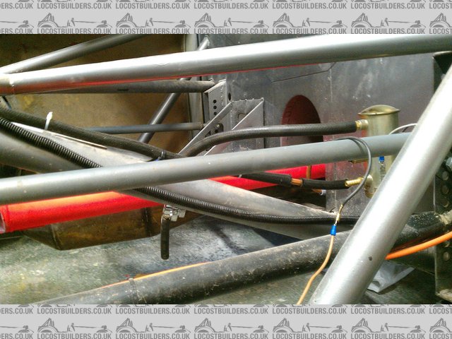

| posted on 29/8/11 at 06:48 PM |
interesting! never thought of that way! might cause a few issues in some places, just gets a bit tight for space in places, but a very good idea!
here's some pretty vague photos, its not an asy area to take photos of really.
there is some convoluted plastic pipe in there too, this is where i was going to put electrics, but will go somewhere else now. the cotton braided
hose over the copper pipe goes the same way though
and this is where it goes down to the pump
can't imagine my way is less secure than these eBay Item
