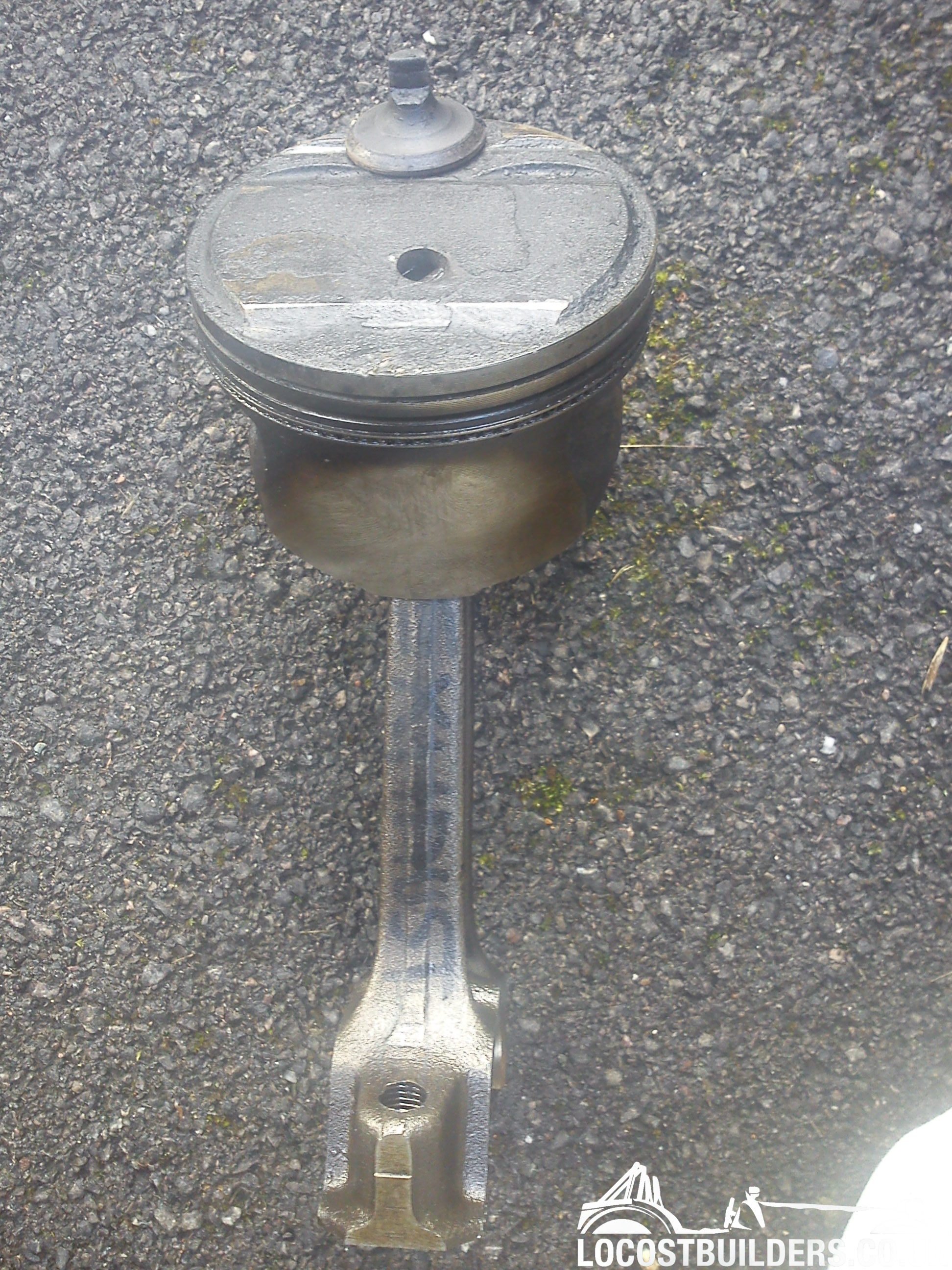

Piston on these are factory paired with liners,

Originally posted by Strontium Dog
How do you know that you need a piston? I have heard a few rumors of head gasket failure on these engines!
This answer your question? Didnt resize image soz!
Thats stupid! Are the liners easy to change i be they come out through the freaking bottom dont they!?
