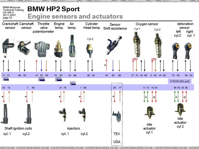

I've been going through all the sensors that the BMW bike engine came with and I'm surprised there's no MAP sensor... just an Air
Temp Sensor in the airbox.
I'll be bastardizing the OE airbox to suit my frame... is it worth adding a MAP sensor?

If the BM has an airflow meter no map sensor is needed, if theres nowt in between the air filter and the throttle body measuring whats coming in, then
there will be a map sensor or the other way is using the throttle position. Theres another way of measuring and I cannot recall how it works Scott.
(alpha N)
Is there a sensor plug on the throttle spindle ?
If your going to use a DTA - you can use map as load or throttle , no doubt the mocal will do the same, so it might not matter at the minute until you
decide what setup etc.

No MAF sensor on the bike... just the Airbox Air Temp, Throttle Pot, Idle Actuators and Lambda's.
It's Evolution Baby!

So, thinking aloud. No MAP sensor, and no MAF. Therefore the stock ECU must be running alpha-N?
My guess is that the MAP signal will be pretty lumpy, but when the guy tuning it wants to use the signal from the MAP it will be better for him to see
its lumpy than waste time discussing it. It might be that a MAP signal is useful at low engine speeds.
If it were me I'd run the stock BMW ECU and not bother with a MAP sensor.

Having seen that I'd definitely be running BMW management. If it has 2 lambda probes and 2 det probes then it must have some intelligence and
so surely it will deal with the small changes from a modified exhaust.

Thanks Matt. Unfortunately the BMS-K ECU is linked to the bikes 2D Dash via can-bus and is notorious for throwing hissy fits when a component is
missing (and I can't afford to buy the lot).

Like Matt says - will be worth giving it a go using the beemer ecu first, if your not planning anything else other than an exhaust change , which in
reality isnt going to be much more/less than the bike one. Is everything else staying stock ?
It doesnt look like the BM is measuring the air into it, so is using throttle position & rpm to manage the fuel/ignition
Without getting my book out alpha n is - A for throttle angle & N is rpm - best go check now methinks.

It would be great to get the use of all the sensors, but I guess I can live without the Cylinder Temp and Knock sensors (the S80 allows for two
Lambdas).
I guess I could hook the cylinder temp up to a spare dash channel just to keep an eye on things and I can use one of the Phormula Knock Sensor kits to
map it then monitor it.
