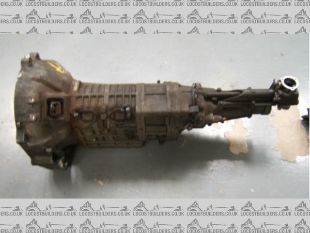

Just had a look... it is dinky!
I'd need a bespoke (longer) input shaft to make it work though
It's Evolution Baby!
Or a splined coupling made up....
