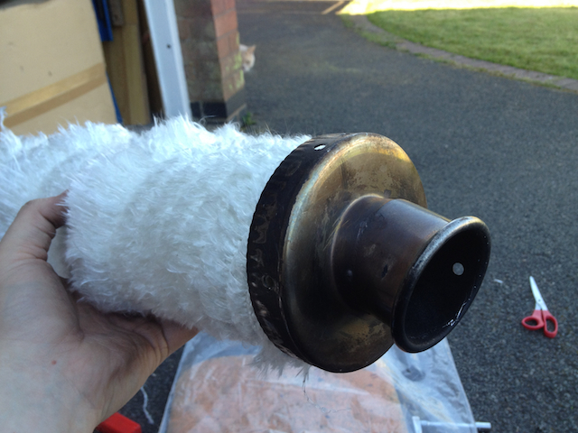

| posted on 28/3/12 at 11:15 AM |
being honest I wasn't sure how much to put in, but I did the calculator thing on their website, so I just put in the amount they stated...
here are some pics of the process for those that can tell me I've done it wrong lol
loggyboy
| posted on 28/3/12 at 11:38 AM |
Looks very different to the PTX stuff.
