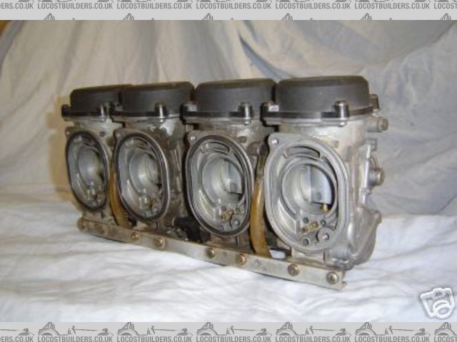

A guy on another forum confused me by saying that I should know what kind of carbs I have to match the pump (get either electrical or vacuum pump)
My zx6 pump looks like this
Carbs are from a 750 and look like this
Hope I did everything right

beqa16v
| posted on 6/5/12 at 07:12 AM |
The ZX6R fuel pump has arrived. will pick it up tomorrow. any instructions before I install it? Does the pup say where the negative and positive
should be connected? Will it be damaged if I mess those up? Any other tips?
PS. I have the engine in the rear so the pump will be close to both engine and the tank.
whitestu
| posted on 6/5/12 at 09:00 AM |
Does the pup say where the negative and positive should be connected? Will it be damaged if I mess those up?
Hi
It should look like this:
[img]
[/img]
The wires to the connector are black and red. Red is live.
The one with the filter on is the fuel inlet.
They are best placed under the tank so gravity primes the pump.
Stu
