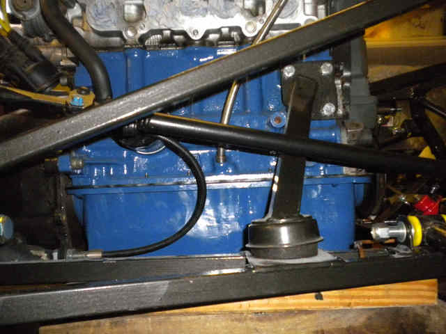

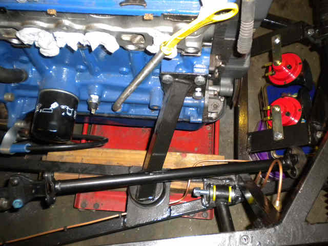

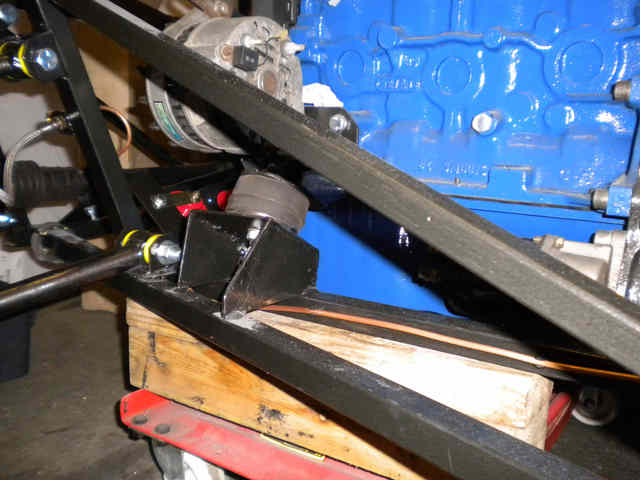

will121
| posted on 28/5/12 at 05:17 PM |
i made mine and added photo's to the album below, not easy to get a photo of them but hopefully show where i mounted them on the block, mine fit
different to the chassis as in a locust but you should be able to do something similar

jwallbank
| posted on 3/6/12 at 06:58 PM |
Hi,
My mounts came with the engine from a Westfield. Mountings bolted direct to block into original mounting holes.
John W
