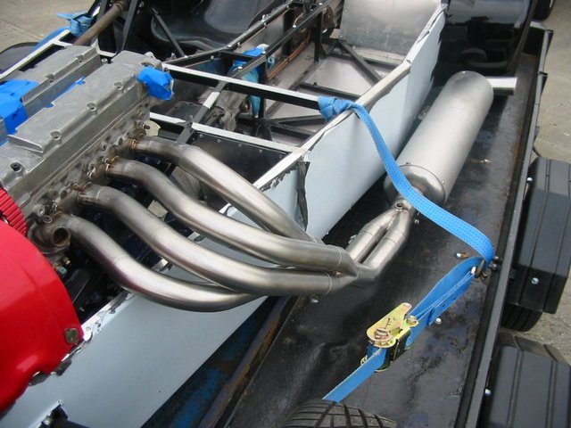

Wheels244
| posted on 12/6/12 at 09:14 PM |
Here's mine - paid for by Ned
  another angle
  on trailer again
