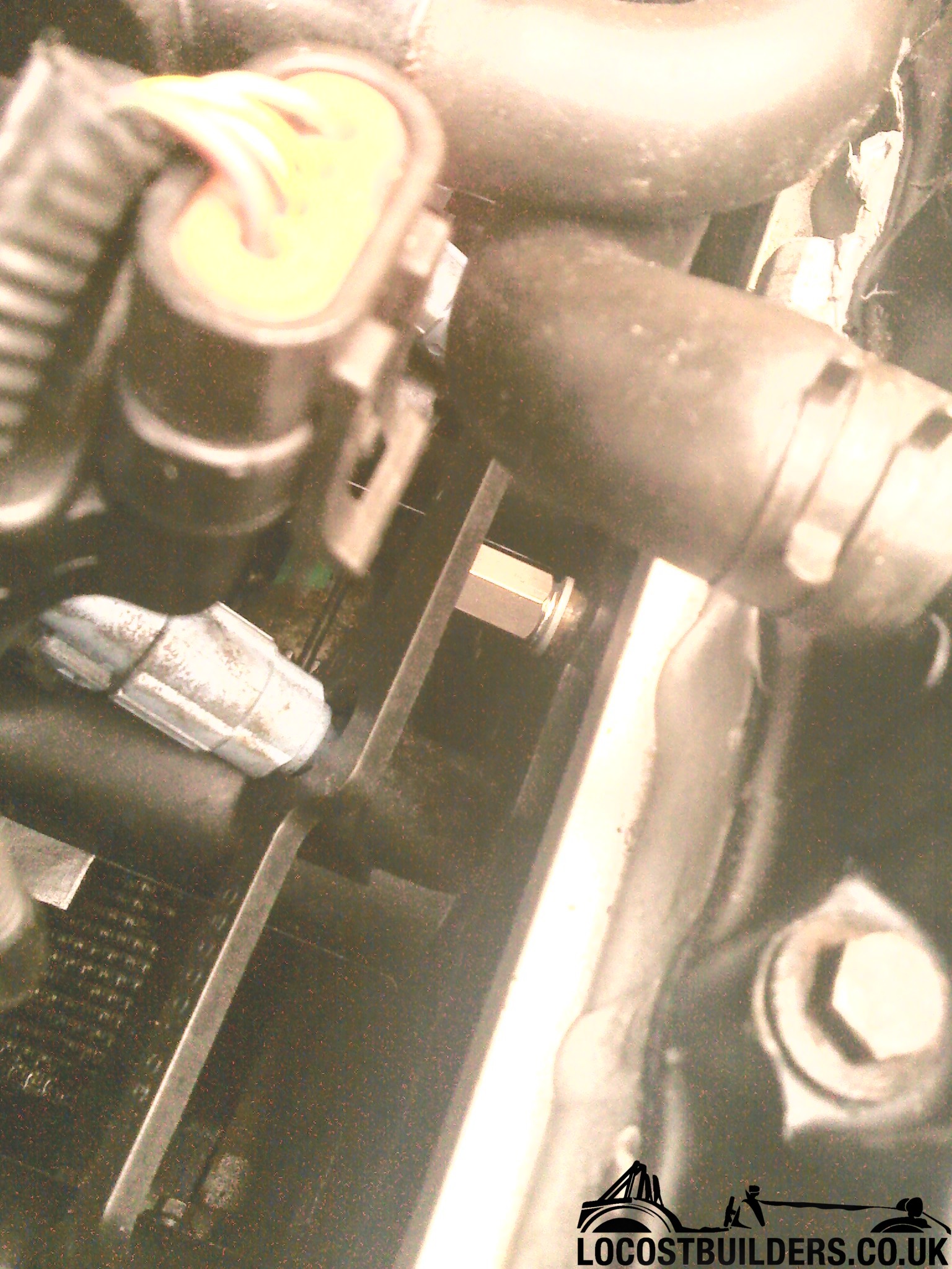

britishtrident
posted on 6/8/12 at 11:55 AM Reply With Quote
Note extra washer under inlet manifold nuts.
