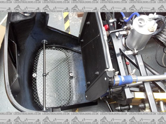

It's standard practice to fit an expansion/header tank on BECs. Ours can be seen on the top left in the picture below.
Engine pic
Engine pic
