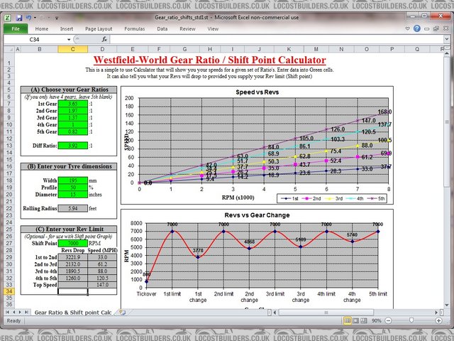

Xtreme Kermit
| posted on 27/8/12 at 08:30 PM |
you can see the effect here, courtesy of this excel sheet.
http://westfield-world.com/Gear_ratio_shifts.xls
This is a standard type 9. You can see the drop off in revs from 1st to 2nd.
  Type 9 std ratios
This is a long first set up. You can see the revs drop nowhere near as far, and the engine will remain 'on the cam'
  Type 9 long 1st
