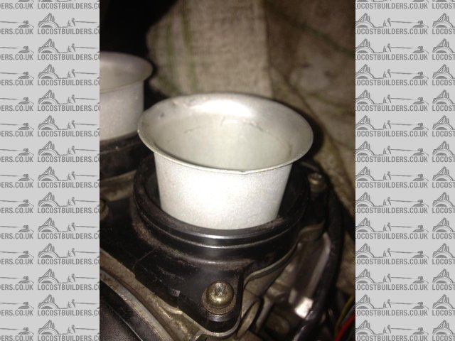

cbr900 plenum to carb method
In terms of a turbo plenum on the above picture should the plenum base attatch to the trumpet or to the black plastic rim below ??
It would be a better job if it could attach to the plastic but there are little ports and brass little tinkers behind and am not sure if they should
be pressurrised or not ??
any help appreiciated .
TIA Alan

mines attached with some silicone tube attached to the plastic and ally plenum chamber, i can take more pictures if you need them
Thank's, Joe

so yours is atatched to the plastic ?? cool
have U any idea what the brass bits are when U look inside the plastic bit ???
thanks Alan

lol no took the top off and thought bugger that and left it alone
trumpets are left on too
