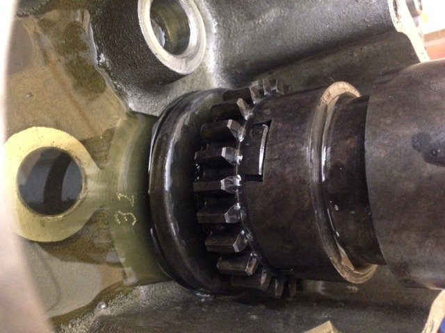

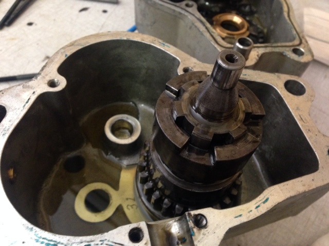

| posted on 3/5/14 at 04:06 PM |
Christian, I have been looking at the internals of the gearbox, I cant see a simple way to reduce the backlash other than build up with Braze
"false Dogs" a lot of work to for a bit of quiet, the spacer I have removed, I took a pic of to show where I found it. its in the bin now,
1 to visually show the amount of "clearance" in the dogs, and 2 pics to show just how much lash there is,
Something different, Very different..............

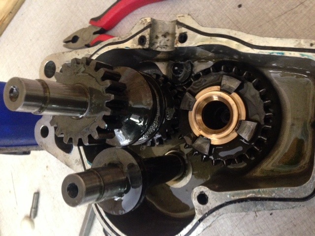

| posted on 11/8/14 at 12:59 PM |
I have dismantled my reverse gearbox and took some pictures of the internal bits, and as you can see i have almost no backlash on the dogs.
But i can see that you have a different kind of bearing were the two axles joins and i have a bushing with a very big play and that results in a very
large amount of vibrations in the propshaft, thinking of replace it with a needle bearing, but that have to wait until winter because that will need a
lot of work and I dont want to have it in the garage in this nice weather.
//Chrilla
