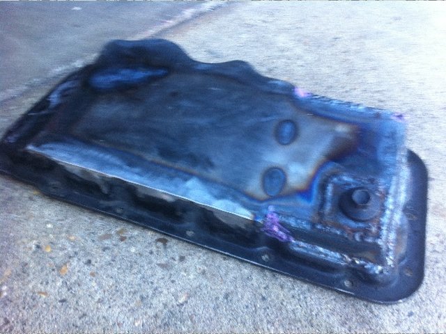

My zetec blacktop custom sump
this is my zetec sump which is now 95% complete just wants 2 more baffle plates cut and welded in... i have shortened the pick up but didnt take any
pictures of it.
[img]
[/img]
[img]
[/img]
[img]
[/img]
plenty more pictures in my album

Looks good, How deep is it ? I did one to the recommended 150mm and it looks a little shallow when compared to yours.
Ive got a spare I will need to have another go.

i didnt do mine to any measurements i just kept putting it on the engine and seeing how it looked, i will measure it first thing in the morning for
you. i wanted to keep mine as deep as possible to maintain oil capacity as you may notice i welded a 'box' onto the flat end aswell to
increase capacity. i think i took about 30mm off the side with drain plug then i made the bottom just sit with a very slight tilt
like i say ill measure it as accurately as i can tomorrow

only reason I ask is the silvertop is 165mm but 150mm is the figure floating about for the blacktop

Surely it depends on the car, one might sit lower than others. I brought mine to the same level as the gearbox bellhousing.
Worth noting the base of the alloy sump is not level with the floor line, both left right and front rear..

looks good. make sure you get all the weld splatter out and clean up the oxide from welding. strong hydrochloric acid works well

The sump plug in the first photo is in a daft place, will certainly get knocked off since it will be the lowest part of the engine. There is a good
reason manufacturers always fit sump plugs on the side.

Alot of motors have the the sump plug on the bottom of the sump, your obviously not a car mechanic are you? No disrespect meant. I am going to have a
sump guard under sump aswell as I've seen many of these have the sump taken off even with modified sumps!

I am not a mechanic but I have been driving for 39 years and have carried out maintenance on most of those cars. I built my first kit in 1988 thus
have been round the Kit Car scene for 25 years.
In all that time I have never seen a sump plug on the bottom. Every manufacturer has put them out of danger on the side.

Never owned or even looked under a Honda Civic thus I will have to take your word. However, I can guarantee that the sump plug will not be the lowest
part of the car.
But with regards to a Seven with fek all ground clearance (mine has 75mm under the bellhousing, probably another 5mm under the sump) why on earth
would you want to reduce that by the length of the sump plug which would be the lowest part of the car. Sump guards may solve one problem but can
cause others and only add to the weight of the car unnecessarily.
In my 25 years of owning a Seven I have hit the sump once and that was on a gate stop sticking out of the road, small crack in the sump which resulted
in virtually no leak and was soon sorted.

I've built lots of these for people now. I always put the drain plug on the side of the sump because it will get ground off if you don't.
If you have the room for a sump guard you've still lost about 20mm because of the plug and if I had that much clearance I'd use it for oil
capacity! The sumps I do have evolved from the first ones I did into what I build today after trial and error and feedack from people on here!
I am surprised at Honda for nfitting a drain plug on the bottom of a sump, but then they did fit oil flow restrictors in the feed to the head on
cx500's resulting in them ALL eating there cams etc and having to be recalled IIRC! So not the first mistake they've ever made!
