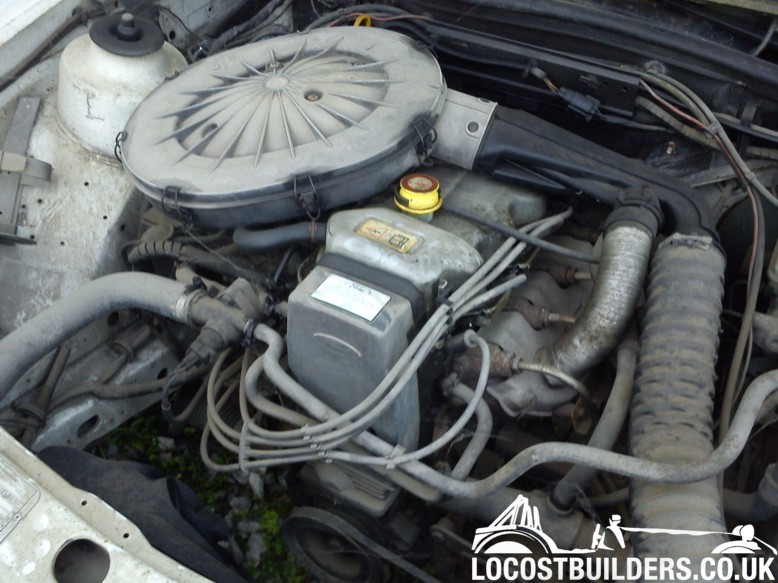

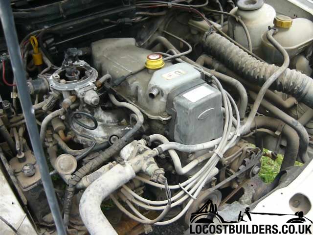

xico_ze54
posted on 16/5/13 at 09:26 PM Reply With Quote
Originally posted by Not Anumber
If it is any type of Ford petrol engine of that era then it must have a coil. Either a traditional single coil with a single HT lead to a distributor cap or a twin coil pack with 4 HT leads straight to the spark plugs.
here is a pic of the motor.
http://www.viseudesign.com/Sevenesque-36.htm
