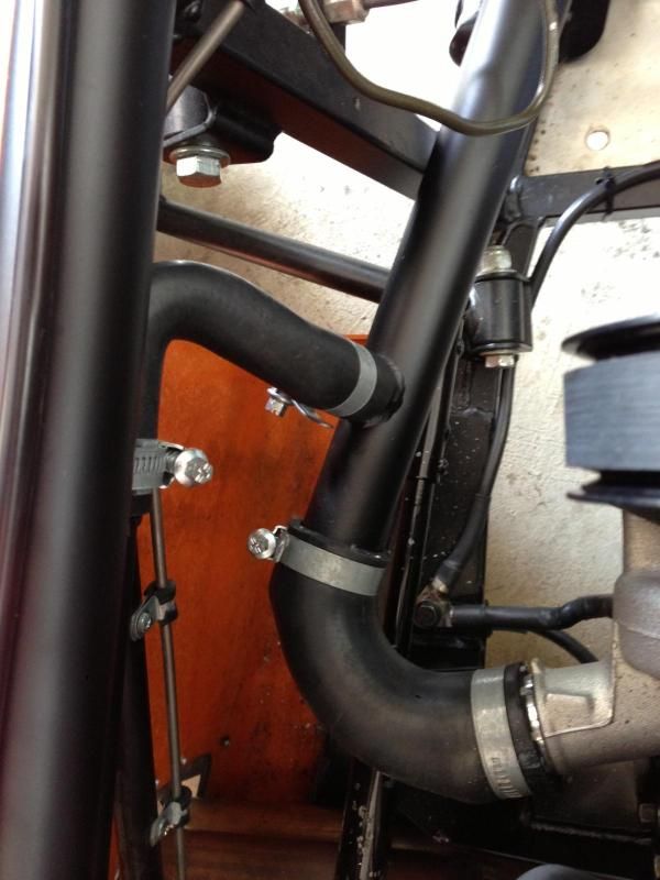

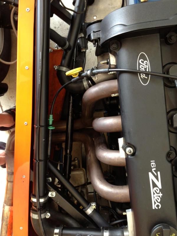

Here you can see a picture of the thermostat bypass line connecting through a Y-pipe with the line from the expansion tank. And then Tee'd before the waterpump.
It may be hard to see the pipe since its beneath the big pipe going from the thermostat to the upper end of the radiator.
britishtrident
posted on 2/6/13 at 11:10 AM Reply With Quote
It is actually fairly normal most tintops do it to some extent, a bigger flowing by-pass will reduce it but it won't get rid of it completely.

posted on 3/6/13 at 09:27 AM Reply With Quote
Separate the header tank and bypass connection.
The header tank connection should go as close as possible to the rad on thee bottom hose and the bypass hose as close to the water pump as possible.
That will solve the problem.
