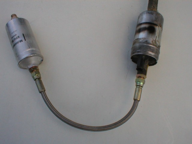

| posted on 19/10/04 at 08:15 AM |
Heres what i did with my cossie pump. No one way valve in sight?
Jeffers_S13
| posted on 19/10/04 at 11:05 AM |
So you didnt bother with it then ? does the connector you used just simply cover/block the radial holes, the fuel feed therefore going straight out
the end into the braided hose. I suppose I could just slide a piece of normal fuel hose straight on the end then and jubilee clip it on then ?
Where did you get the braided pipe ? and is that the fuel filter it connects to ?
Plenty of questions ! I'll be back in a few mins for the answers !

SeaBass
| posted on 20/10/04 at 01:25 PM |
I believe the fitting your talking about with radial holes is actually the body of the non return valve fitted to the pump. It's designed for a
banjo fitting isn't it?
From research I did when looking at fuel injection. The non return valve isn't essential but will mean the engine wont start first time. Will
take couple of seconds for fuel to fill pipes again.
