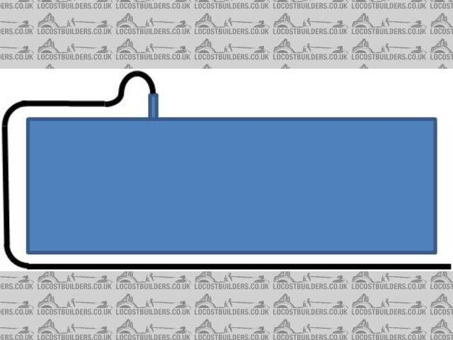

I used this:
Took advice from the IVA techies first and they seemed to think it was fine. It passed the IVA OK so must have been
The idea is that no matter which way up the car is it should not leak fuel, yet can still vent both ways.
HTH

quote: Originally posted by Daddylonglegs
I used this:
HTH
Yeah thats work except...
A. If your filler neck is higher than the little loop and you over fill the tank up the filler neck, it'll loose fuel untill below the loop
level.
B. If the tank is full of cold fuel direct from underground storage tank it could expand up through the breather.
C. Assuming view from the rear, cornering hard right, fuel will travel up into the pipe (especially when full) and when returning to straight or left
turn, some will return to tank and some will dribble out will.
I'd put a float valve in and all three problems will be addressed.
I had a one way valve and had problems when in the Alps. I bodged it to your design while away and ran like that for a year or so with occational
drips. Finally forked out for a 2-way valve and not had any issues since.
