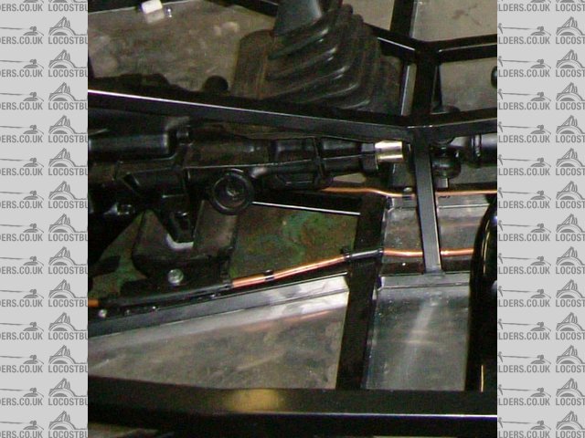

indykid
| posted on 27/10/04 at 10:09 PM |
my gearboxin the indy is supported using the standard bracket (drill the rivets in the big chunk as standard to leave the metallastic bush section)
this is then supported on 2 steel strips welded to the diagonal bottom tubes of the tunnel to make fixing flanges essentially to support the gearbox
bracket. drill and bolt through. bolt gearbox to bracket with original bolt and robert's your dads brother as they say.
will try and get a better pic soon if i'm not beaten to it
tom
