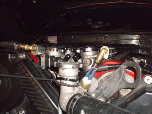

The airbox / filter issue is something I have been looking at for my Mx5 setups for a while - and I think I may have finally made progress
I've made some very short trumpets to gain as much space above as possible , and am in the proces of working out how to mount the fuel rails
with peco-style short injectors (these sit the rails level with the top of the bodies and allow a much larger , simpler airbox )
The idea is to have as large an aibox as possible within the space , with ducts off either side running forward to two cone filters , somewhere cool
air is available.......

| posted on 4/5/14 at 08:48 PM |
I got my `new' throttle bodies sorted and fitted yesterday , and the end result is.......loads of space above for a massive airbox .
The most likely layout is a box with two pipes at the rear , pointing sideways , then 90 degree elbows to ducting placing twin cone filters one behind
each headlight .
At least , thats the current plan.........
