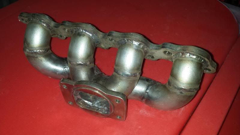

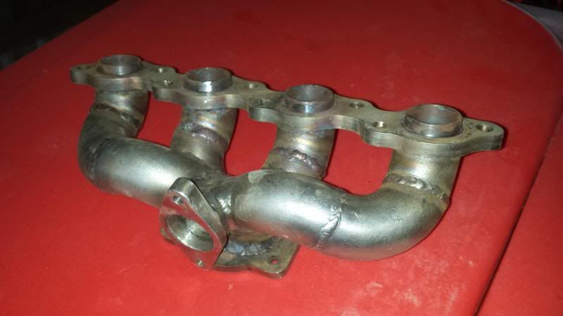

I built my manifold from "butt-weld fittings" from www.zx55.com very good price
I used 1.25" schedule 10 bends in 304 stainless, then got some flanges laser cut from 304 also. Tigged it up and ended up with this for my TD04 turbo and 38mm external wastegate
