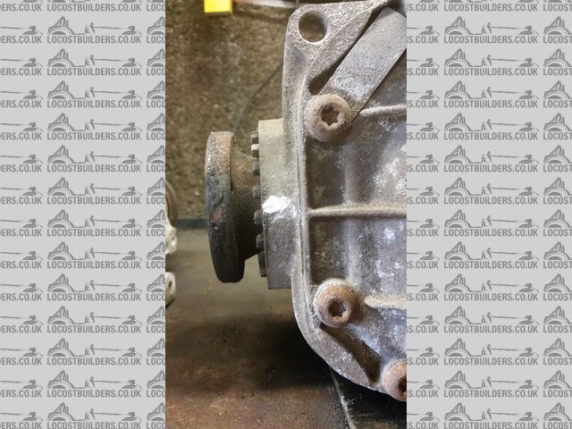

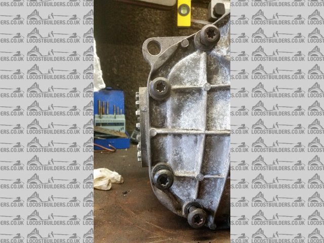

phil clegg
| posted on 26/10/14 at 02:38 PM |
Pictures of diff
  Smalldiff1
  Smalldiff2
mookaloid
| posted on 26/10/14 at 02:56 PM |
Are those even the same diff? they look different.

phil clegg
| posted on 26/10/14 at 07:58 PM |
diff
the right hand has an output for bolt ons ignore this,the difference is marked in white paint , standard on right slimmer on left..
